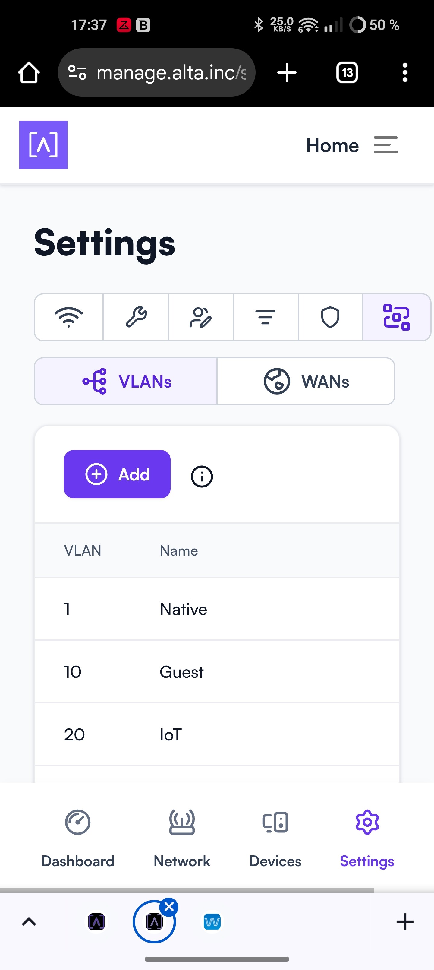

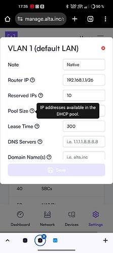

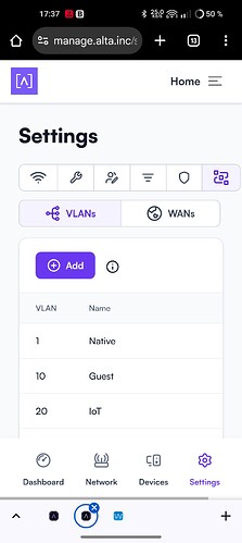

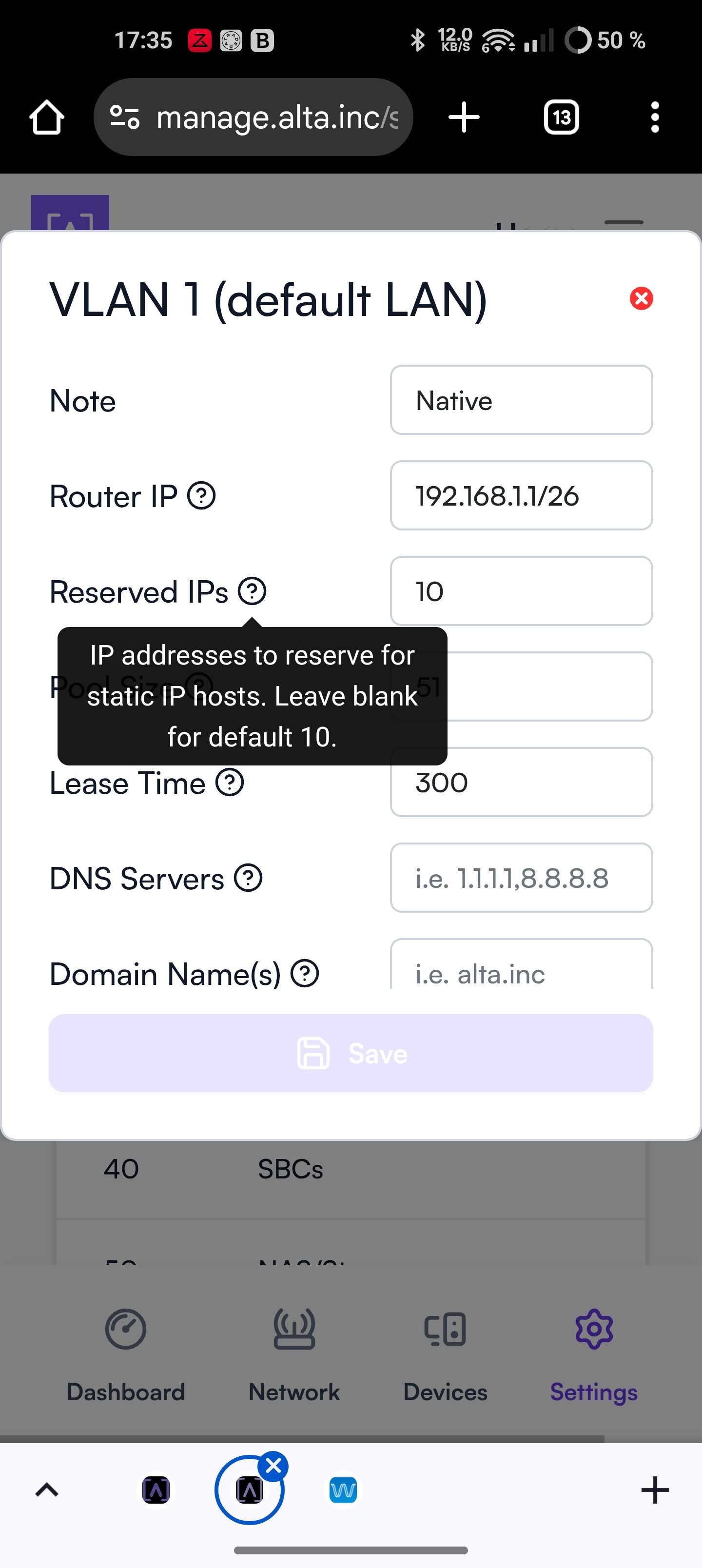

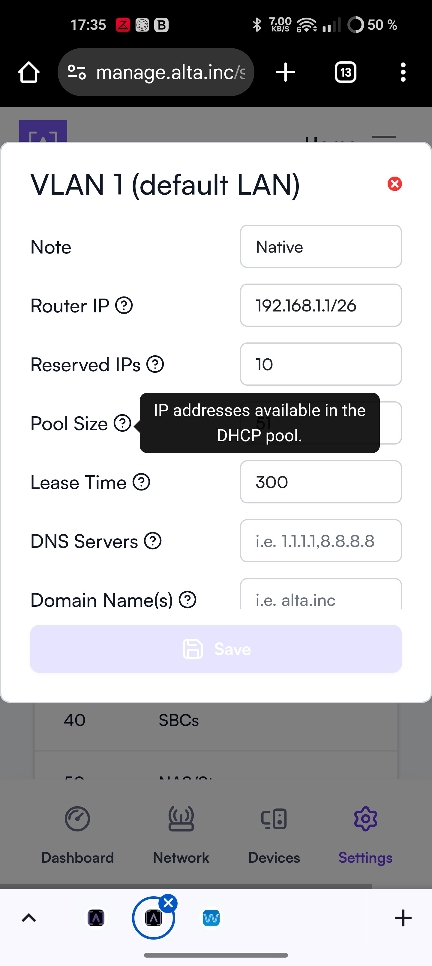

Should be configurable through Settings → VLAN settings.
a) Router IP and subnet per VLAN (Router IP for Default/Native VLAN 1 corresponds to Router’s IP address on the network?)
b) Reserved IP and Pool size.
Pool size is reflected by changes in the subnet but can also be changed separately, though I don’t know how that works with respect to the subnet.

I manage to connect the Router10 using WAN2 (SFP+) and configure WAN1 as LAN port .

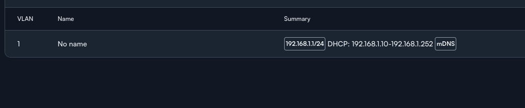

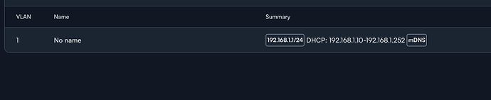

The strange thing is that Router10 auto assigned me a 192.168.0.x subnet but in the management portal on the internet is showing VLAN1 the DHCP scope is 192.168.1.10 ( see below)
