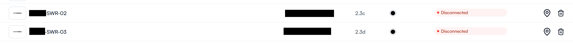

Updated the switches 10 minutes ago and have lost access.

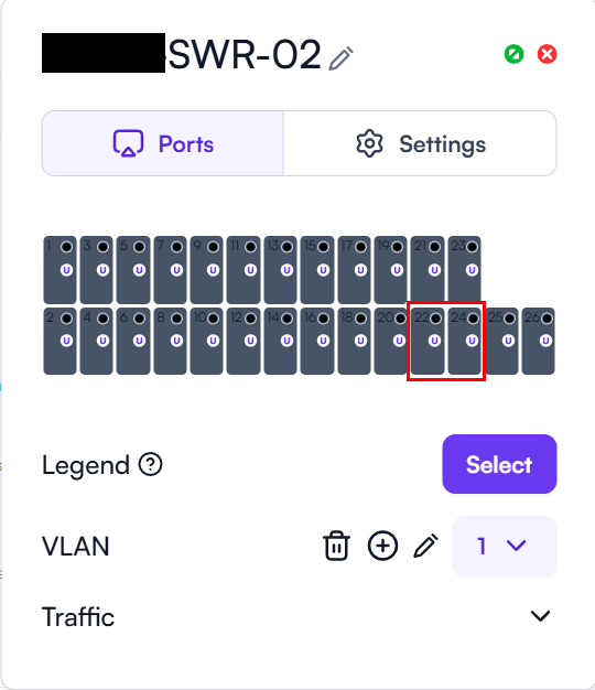

There’s an SFP+ issue with your S24 again. Interfaces are showing down/down after this update.
Right now I have it temporarily online via copper connection from my
S24/Interface 24 <> R10/L3
I also needed to daisy chain the S16/Interface 16 <> S24/Interface 22 to establish connection to that device. It appears as if none of the interfaces on your S24 seem to be functioning correctly.
Current status of the S24 via GUI. No activity shown for interfaces 22 & 24 where it’s currently connected.

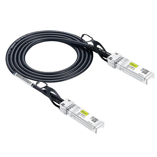

I thought it was my DAC cable had gone bad, but you are totally right! I had to pull my DAC cable after the last update as well.

For what it is worth, below is the information on my replacement DAC. I have installed it and rebooted the system. So far so good.

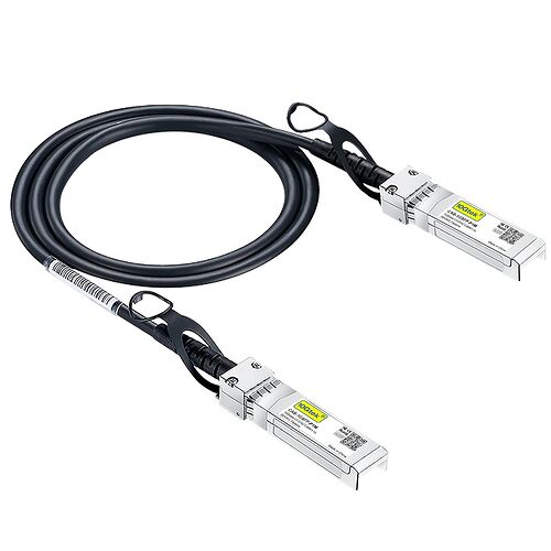

That is the identical DAC I had that seemed to stop working. Interesting
Which? The 10gig or the 1gig?
Sorry I should have specified. The 10G SFP+ model.

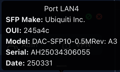

At this point, maybe it’s worth asking what SFP/SFP+ DAC’s you folks are running in your lab for 10g and 1gig?
I’m not entirely sure what all is in the lab as I’m remote from the HQ. My own lab consists of a lot of FiberStore SFPs and from that U company that I used to work for. If I had to venture a guess, I’d say triple digits for SFP quantity, but that’s a drop in the ocean relative to what’s out there.
At any rate, thanks for the reports. I just ordered those and will test them when they arrive. They may even get some S48-APOE and/or S12 love.
