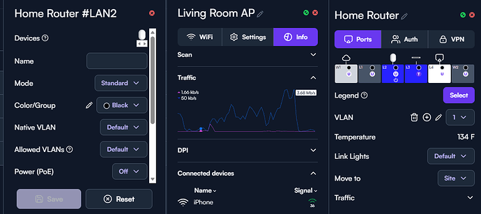

In my Router 10 (1.4k):
L1 was connected to PoE-in port of EdgeRouter X.
L2 was connected to Port 1 of AP6W (2.2s).
In the beginning, L1 and L2 were both with Power (PoE) off.
After setting up L1 with Power (PoE) on and keeping L2 Power (PoE) off, EdgeRouter X didn’t become power-on but AP6W became power-on.

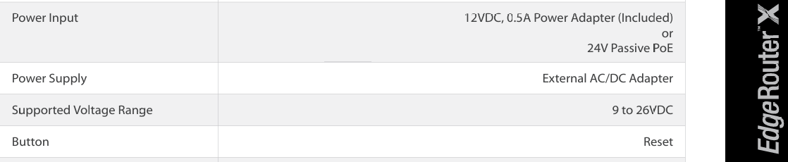

I might see if I can duplicate that behavior on my own Route10, but I believe the EdgeRouter X only support 24v Passive PoE as an input.

Had a minute and I can at least confirm that on my Route10 setting PoE to off on L2 doesn’t seem to work as expected.
It may have gotten out of sync. Check this:
Thanks @ebuckland81 ! That did basically work.
Here were the steps in case someone from Alta wants to try and duplicate this issue: I set L2 from “Default” to 'PoE Off", saved the change, plugged the AP into that port, and it powered on despite PoE being set to Off. Switching L2 to “PoE On”, saving the change, then to “PoE Off” and saving the change, properly shut off power on the port. I then switched back to On again to power up the AP.
