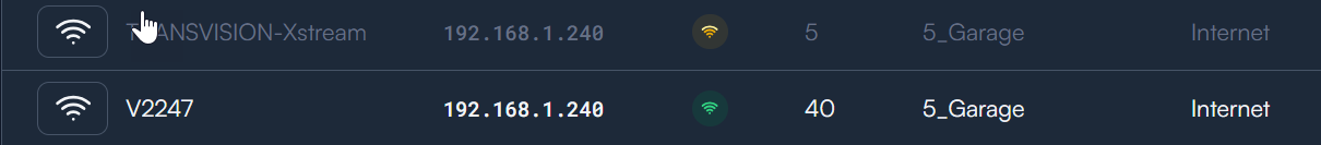

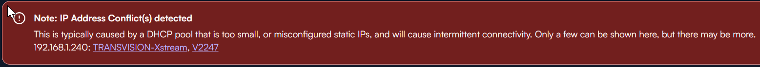

my system lately shows me many IP Address Conflict(s) detected with 2 or more devices.
I checked several time the issue and always find that this is not a real conflict but the system report conflict between connected devices and unconnected devices.
I think this is a little bug that need to be solved. Or either disconnected devices should be removed from the DHCP table at once.

This isn’t something we can reproduce at our test sites or labs, so we need your help to understand what is going on at your location. I’ll DM you to see if you are interested in an invite so we can dig deeper.
It is really easy for me to replicate. Make sure you have at least two switches or two APs in your site, along with a route10. Unplug either a switch or an AP. Reboot route 10. It will then complain the entire time that switch or AP is unplugged, that there is a DHCP conflict with the unplugged device and a still plugged in device.

Quoting part of the initial post above, I would say I agree on it and have seen the same thing. If, there is a non-active conflict, meaning some disconnected device is still supposedly assigned to an IP, and some other device is assigned to and actually actively uses the same IP, it is falsely flagged as an active conflict.

@Astina14 We’re having difficulty reproducing anything similar in our lab… Are both of these devices set to DHCP? Are the APs serving both devices able to communicate with each other on the same management VLAN (this is required, btw)?
@Alta-Jeff
My system is very easy configured there is only one VLAN because it is for my home.
All wireless devices are set to DHCP so there is nothing that is special.
I have not checked if the devices that are reporting the conflict are on the same password.
I just can inform that yesterday I got even IP conflict on 2 disconnected devices but unfortunately I didn’t make a snip of it.
In my opinion disconnected devices IP address should not be in the DHCP table, they still can show on the UI but the system should know that the IP address is available because the other device is disconnected.
I go on the device list and press forget on the disconnected devices and the IP conflict disappears at once. This should really be an automatic process by the DHCP software. somehow it knows that the device is disconnected so why can it not just forget that device? Problem solved for my site anyway.
