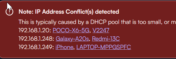

IP Address Conflict(s) detected
@Alta-Jeff
additional information.
The devices are on the same password
So that is confirmed. IP conflicts are on same VLAN and same password.
And the DHCP pool is more than big enough 230 available addresses and maximal 40 devices connected.

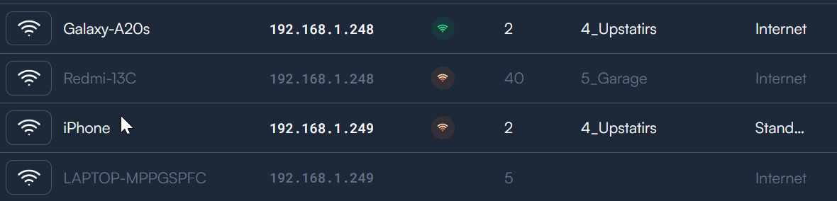

@Alta-Jeff ,
There are more and more conflicts
and this is how it looks like in the device view.
Just for info
Just an idea. Are the disconnected devices always removable? I have had cases where the disconnected device is sort of pseudo-active, where I could not properly remove the device, with the trash bin button, as it re-appeared as a wired device. Though, the conflict disappears as the re-appeared device looses its IP. Though, not entirely sure this is always the case. If so, that may or may not be related to this issue.

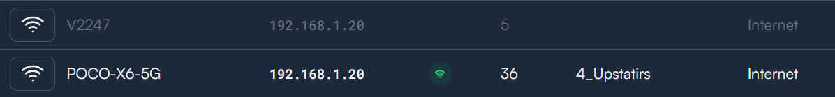

@ebuckland81
The devices are all removable items such as PC, phones, IPTV boxes, printers and other items that will be turned off.
I had not the same issue as you have seen. If I press on the forget button the disconnected device disappears. If the device is operating again it gets a new IP address and no IP conflict (if not an other device is disconnected on that IP).
I have not seen them connected again on the wired network.
So there I have been lucky. But still the IP conflict is not real in my case because it is always towards disconnected wireless devices.
The good thing is that all connected devices are working fine even with the IP conflict message.

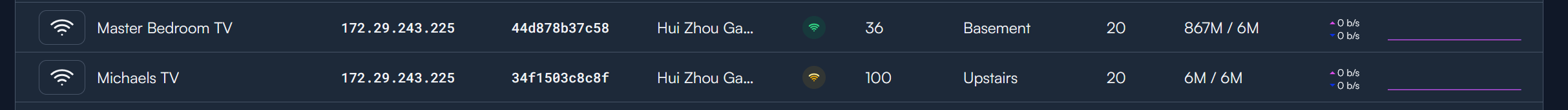

I get an IP conflict error also but my situation is a little different. This is for two Roku TVs on the same VLAN with VLAN isolation enabled. When they go to sleep, they both show a 172.24.243.225 address in the dashboard. This IP is not in any scope in my system. If isolation is not enabled they still show a 172.x.x.x adress but one may have 225 and the other will be 226 on the fourth octet. As soon as they are powered on for use they show the correct VLAN IP address and the conflict notice clears.
Correction. They are no longer getting a different IP if isolation is disabled. They will still get a 172.24.243.225 address. This must be their own IP scheme used for miracast connections or for the WiFi remote and these APs are just picking it up as a client address. These addresses will not respond to any connection attempts and are not in ARP.
So, for whatever reason there is a dormant conflict, between an active or disconnected device and a disconnected device, it is still picked up as an active conflict and the warning is issued.

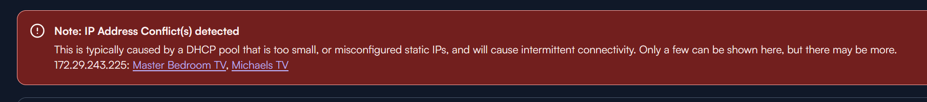

I just noticed another oddity. Mine shows active for both devices vs active/inactive for everyone else. Why are these APs reporting these oddball IPs on these two Roku TVs when they go to sleep?
