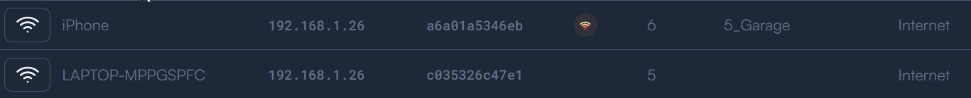

I’m also seeing this
Note: IP Address Conflict(s) detected
This is typically caused by a DHCP pool that is too small, or misconfigured static IPs, and will cause intermittent connectivity. Only a few can be shown here, but there may be more.
192.168.11.23: REDACTED_1 REDACTED_2

@mentalinc
I experience the problem to be on wireless devices only. Phones and computers configured with DHCP. I never experienced the IP conflict on Static IP addresses so that may be different from @ebuckland81.
My DHCP Guard is disabled because there is only one DHCP server in the system.
Further the IP conflict is over the whole DHCP range.

@Alta-Jeff
I was a little too optimistic that something has resolved it self. But today when there was a few more gadgets in the house I got a new IP address conflict.
So the issue is still there and needs some investigation.
