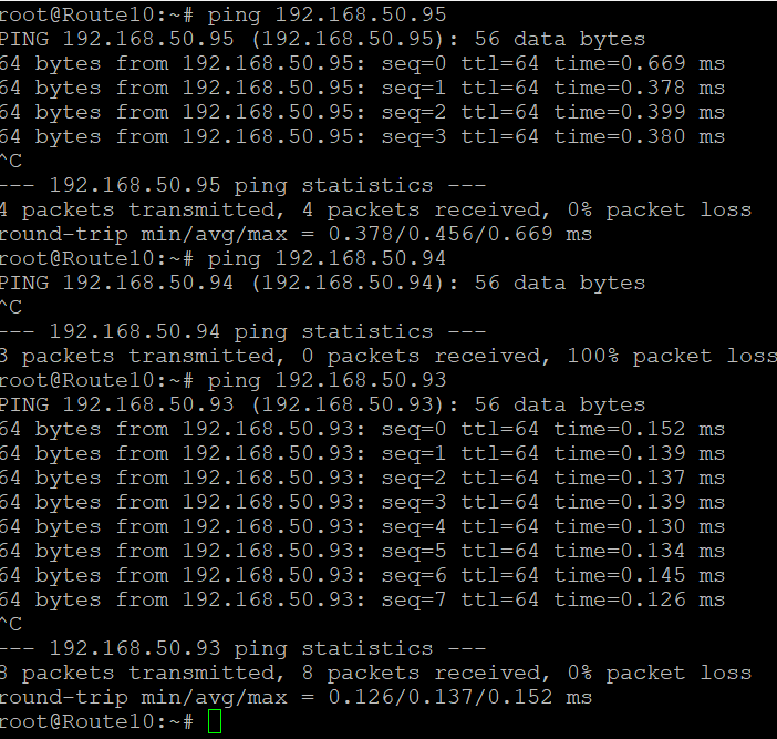

Thank you for this. I’ve been trying your updated script and no cigar for me :frowning: As always, if I change the port to standard from WAN, I can access it. But to revert it back, I need to stick my MiFI to WAN1 in order to change WAN2 back to WAN. A bit annoying.
  • I’m using an XGS-PON ONT vs. WAS-110
  • I’ve changed the ONT’s IP to 192.168.50.94
  • Results after your script
    • I can’t ping 192.168.50.94
    • I can ping 192.168.50.93
# Settings (edit these)
ONT_PARENT_DEV="eth4"          # Port where the ONT module is connected (Route10 default SFP+ WAN is eth4)
ONT_IP="192.168.50.93"          # Router-side IP on the ONT mgmt subnet (choose any unused IP in 192.168.11.0/24)
ONT_NETMASK="255.255.255.0"
ONT_PEER="192.168.50.94"        # ONT mgmt IP (typical WAS-110 default)
