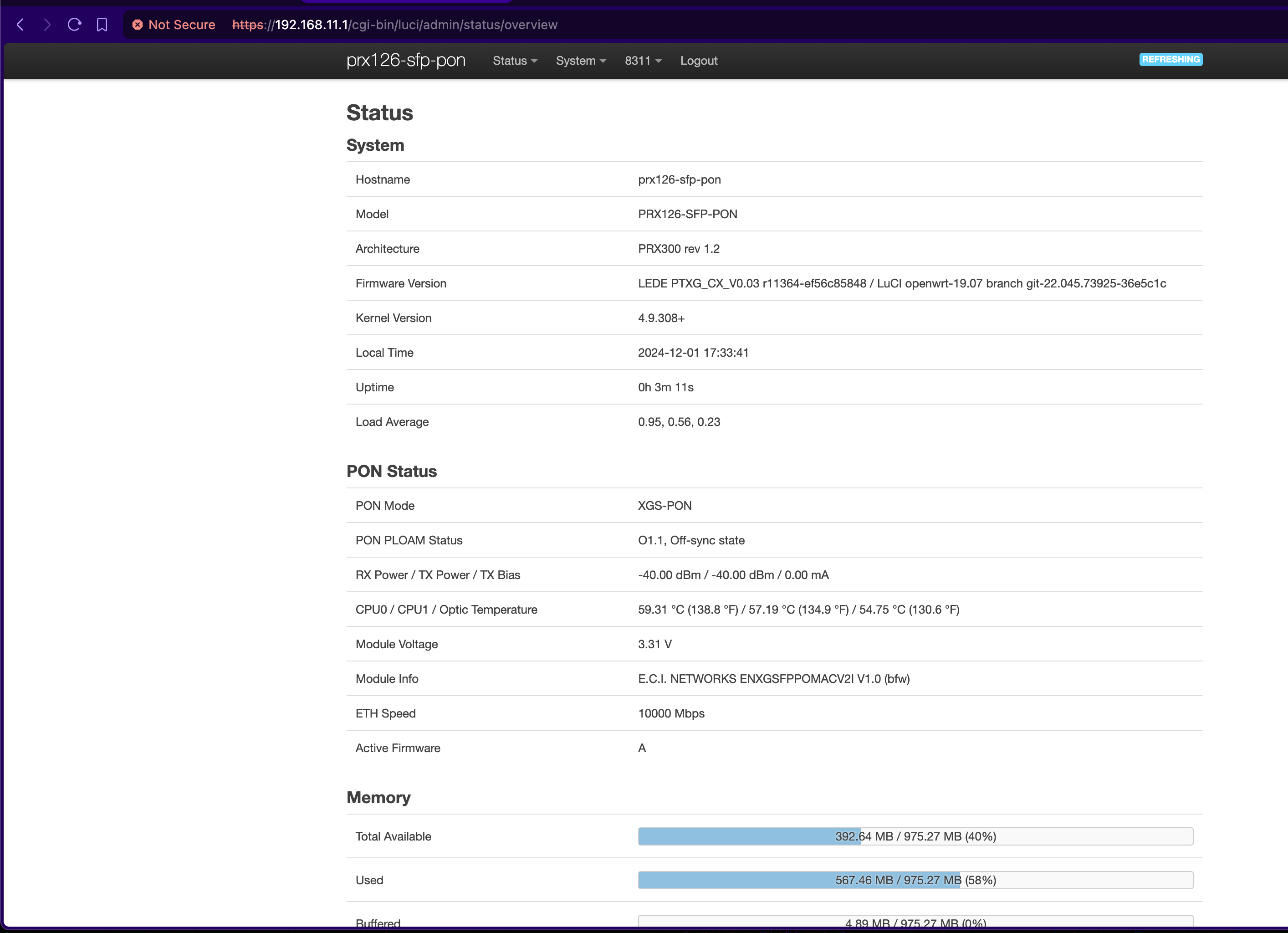

Nice! I have one too, I just haven’t gotten around to fully configuring it. I did install firmware 2.8.0 from the 8311 community, but that’s it so far. I connected it behind my LAN to access it, I did not try it on a WAN port.

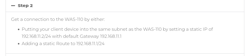

Based on that, connect it to an SFP+ port set to standard mode and set the native VLAN on that port to 192.168.11.254/24 during this process (you can revert after). The 192.168.11.1 will be in the default reserved range, so nothing should get that IP. Please be mindful if you connect a device on that VLAN though, as the first DHCP address handed out will be .1, which would cause a conflict.
I was able to access mine without even having my computer in the same VLAN, so I suspect you should have no issue doing that. That said, I had my WAS-110 wired to a switch on my main network, and not my Route10 when I did it… but it should still work the same way there.
Thank you for you that. I got to work by setting static ip and the gateway. but now i cant access it again. it does pull a ipv4 from my ISP and i do have internet access but i cant go on to the 192.168.11.1 even when i try to set the static ip

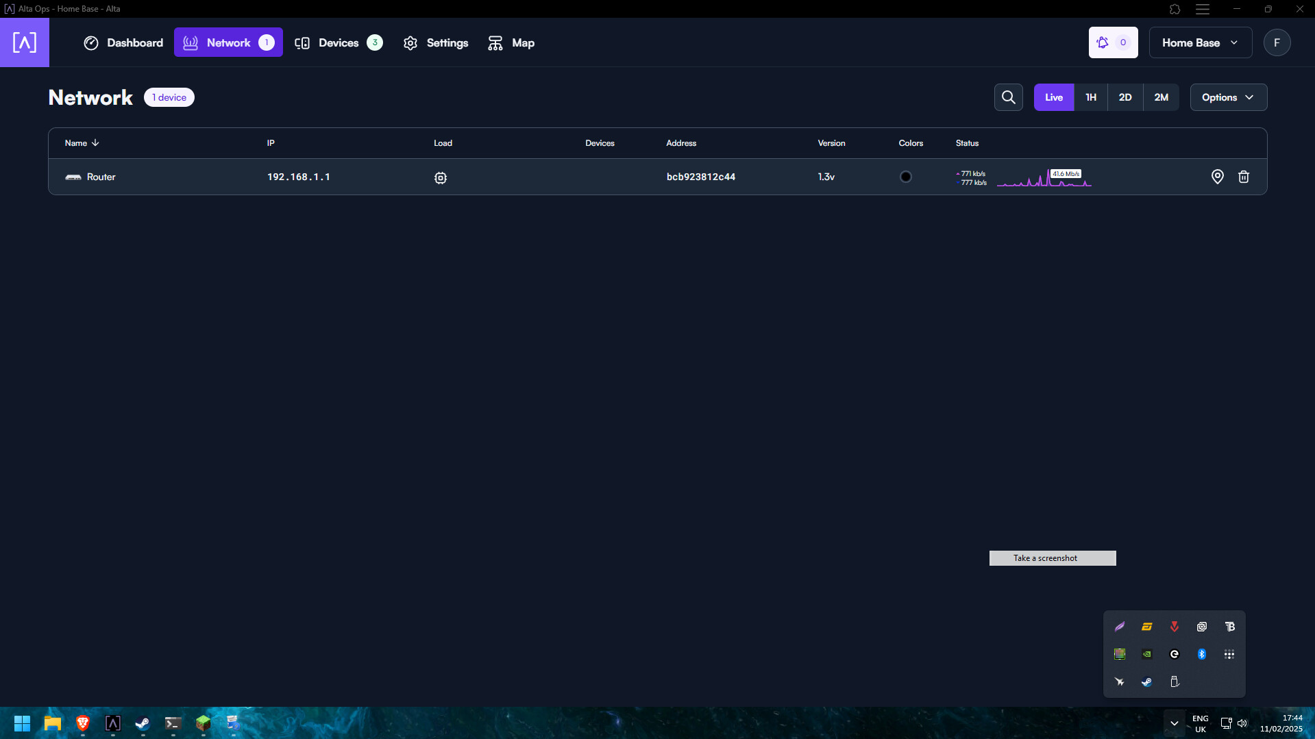

Can you share a screenshot of your Network tab, please?
Is it that the Route10 doesn’t delete at all?
If not, the settings are stored to the site itself. e.g. if you set up a VLAN or make modifications to the default subnet, then delete the device and remanage it, it will just take the same settings as before. If you’re wanting to start with a blank slate:
