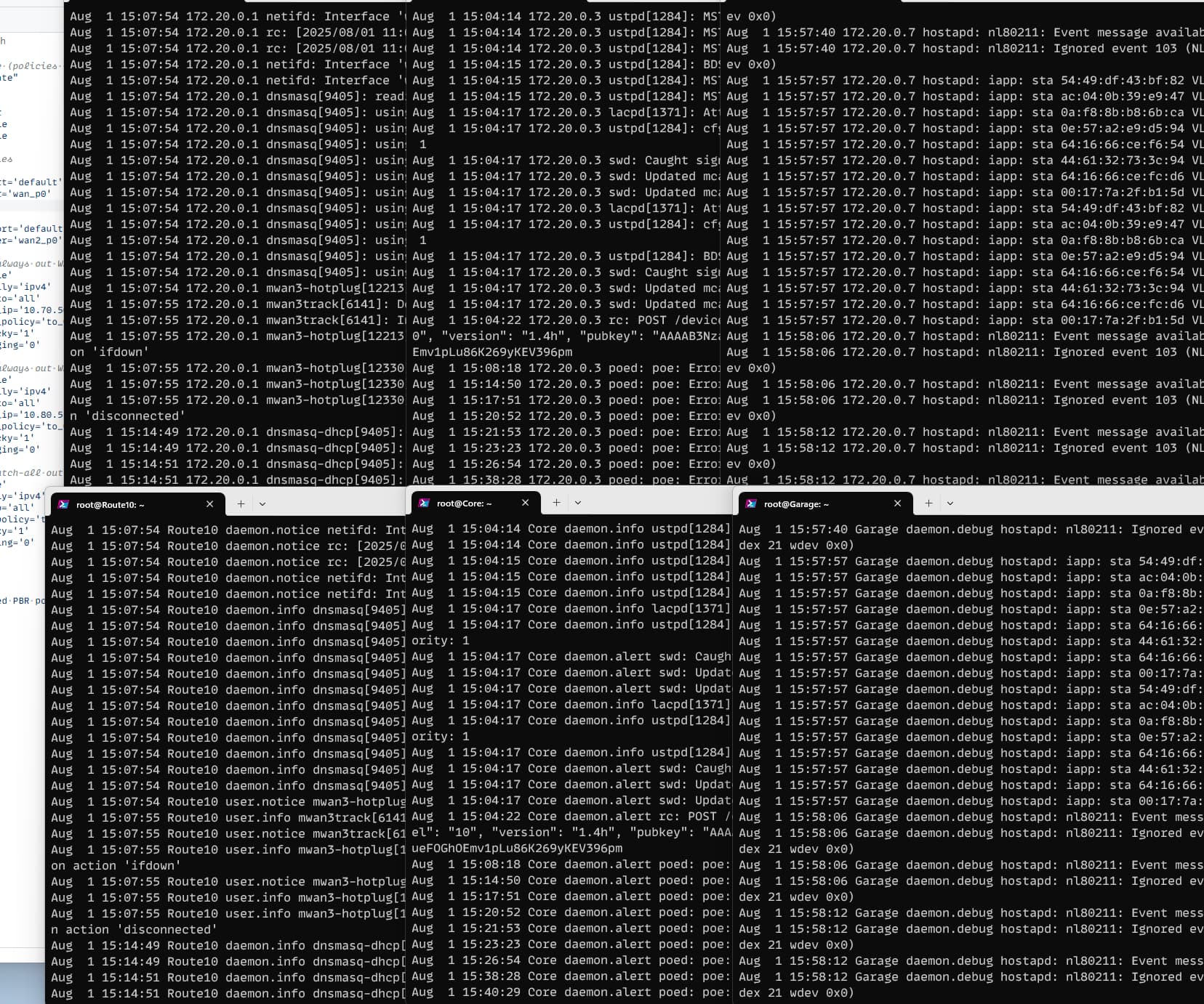

Here’s a direct comparison for example, my syslog collector (syslog-ng on Ubuntu 24.04). Syslog-ng on top from my server, device output from respective messages files below. Appears to mostly align with the Mmm dd hh:mm:ss formatting I mentioned earlier, and it’s consistent, only exception being it seems to render d, or maybe it trims the 0 (I’m not sure expectations there). These are from today, I’m in EDT, so UTC-4 but these times are correctly rendered in UTC as expected. Anyway, I mostly just wanted to show the formatting of the time stamp is not getting modified, by default, which is why I’m wondering if this is related to either to the software itself, or just some customized setting in the collector software.
EDIT: oh, it’s Route10, S48, AP6-Pro-Outdoor, left to right respectively
