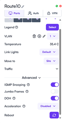

Thanks @Alta-MikeD and everyone! Figured I’d just get this question out of the way real quick since it’ll probably be asked otherwise: where exactly is the option to disable DoH? I don’t need it myself at this moment but I’m just curious where it’s at (I also might be blind :grin:)!
Otherwise so far so good on my end!

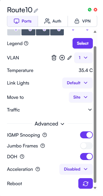

It’s found under Advanced on the Ports section. If it’s not showing up, try a refresh without cache. Cloud only until the next Control tag is released.
Roger! That was going to be my next step and I just hadn’t had a moment to do it yet. Can confirm it’s sitting right there under advanced. Thanks again!
Installed, and over the moon - DoH toggle works lovely!
