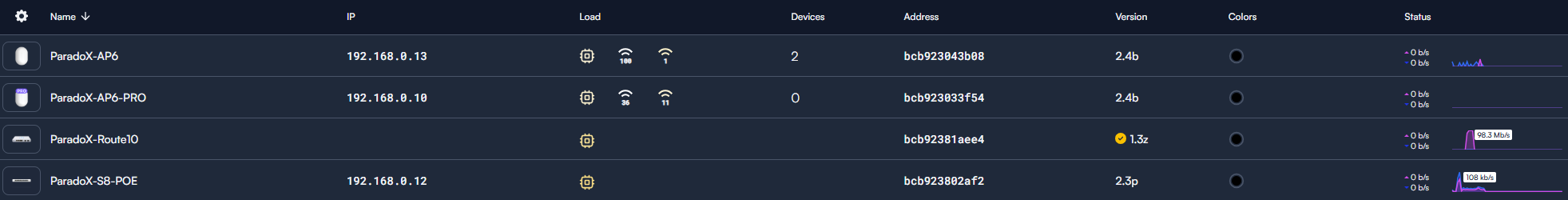

Hello,
 On my end, after firmware update Wi-Fi SSIDs disappeared. Devices are still connected to the SSID, but it doesn't seem to show in the controller. Empty. Rebooted all devices, same result.
