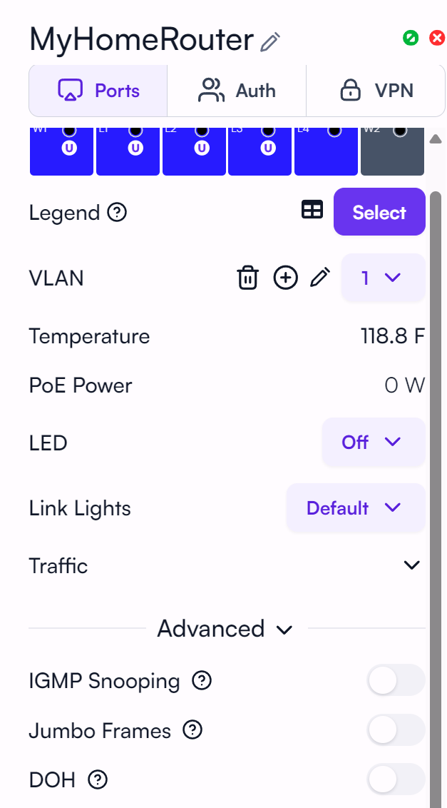

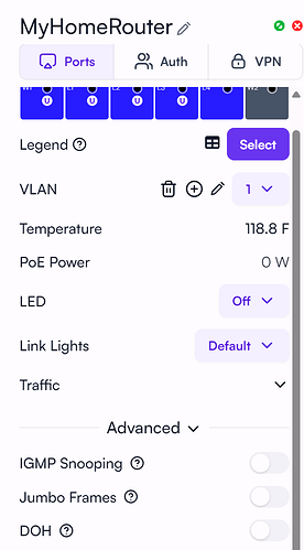

Hi, anybody encountered same issue that Alta Labs default DoH settings blocked sign-in portal for Epic Games? I had to disable DoH to be able to login.
Anybody from Alta can comment on this? Looks like default DoH setting has some ad block enabled? unfortunately there is no option to create a white-list so ended up has to disable the entire DoH setting (less secure).

Have you tried disabling DOH under Advanced on the Route10?
I think it was mentioned that turning off DoH resolved the issue, which is what kicked off the question :wink:
