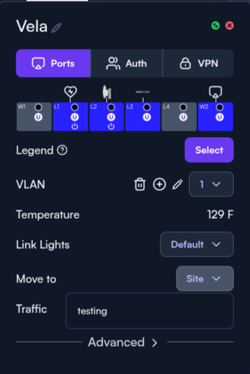

Second, you can use the Move to Site feature, as seen in the below screenshot.
