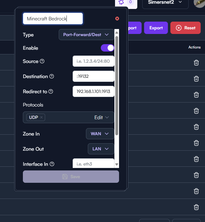

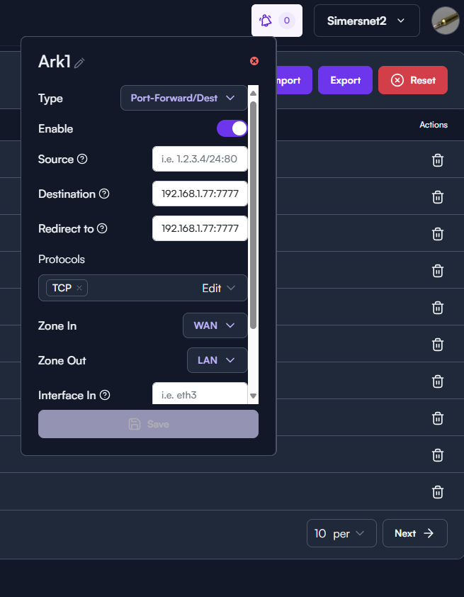

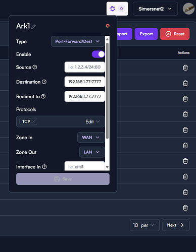

Destination - probably just the port is needed if doing it from WAN.
Redirect to - just the IP address of the host running the service.
If you’re also trying to map to a different port than inbound then gets more complex.

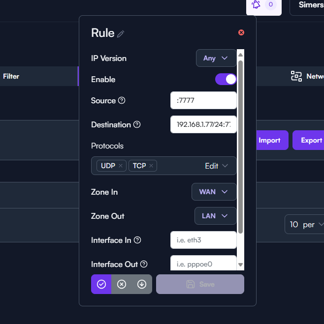

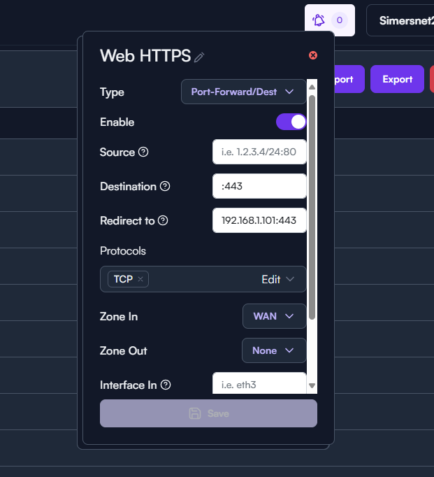

certainly. examples. I have tried combinations of using the ip and port or just port makes no difference. also seriously when should I use a filter or a forward? are they the same thing?

firewall.@rule[10]=rule
firewall.@rule[10].target=‘ACCEPT’
firewall.@rule[10].proto=‘udp’ ‘tcp’
firewall.@rule[10].src=‘wan’
firewall.@rule[10].dest=‘lan’
firewall.@rule[10].src_port=‘7777’
firewall.@rule[10].dest_port=‘7777’
firewall.@rule[10].dest_ip=‘192.168.1.77/24’
it’s listed in there.

I see a bunch of permanent rules, could they be releated? *viewed through ssh (uci show)
You don’t need to add the port on the redirect to.just need to add the ip address
