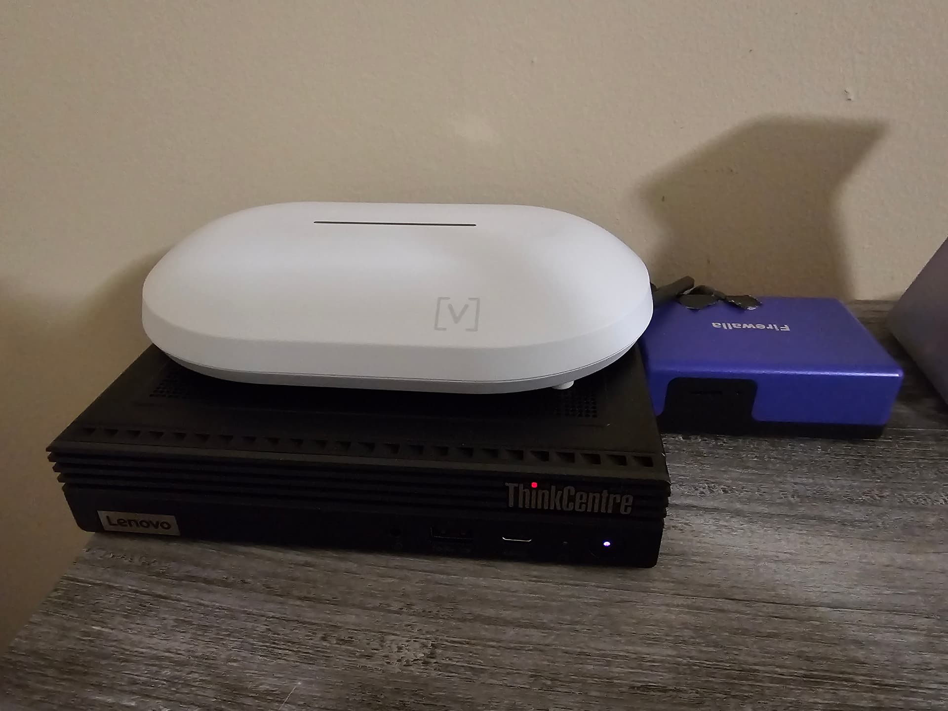

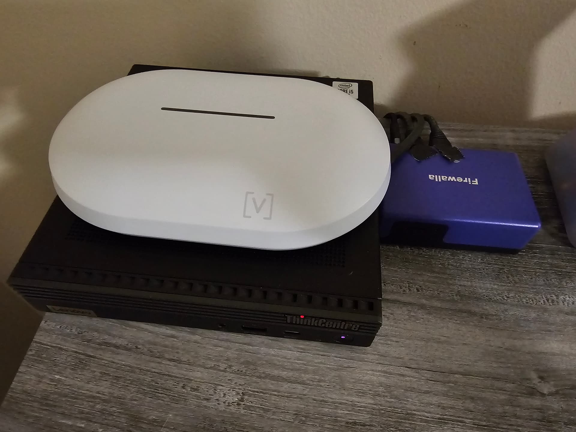

My small 1 bedroom apartment setup
ATT fiber modem > Firewalla firewall > switch > Alta AP + Lenovo running adguard DNS server

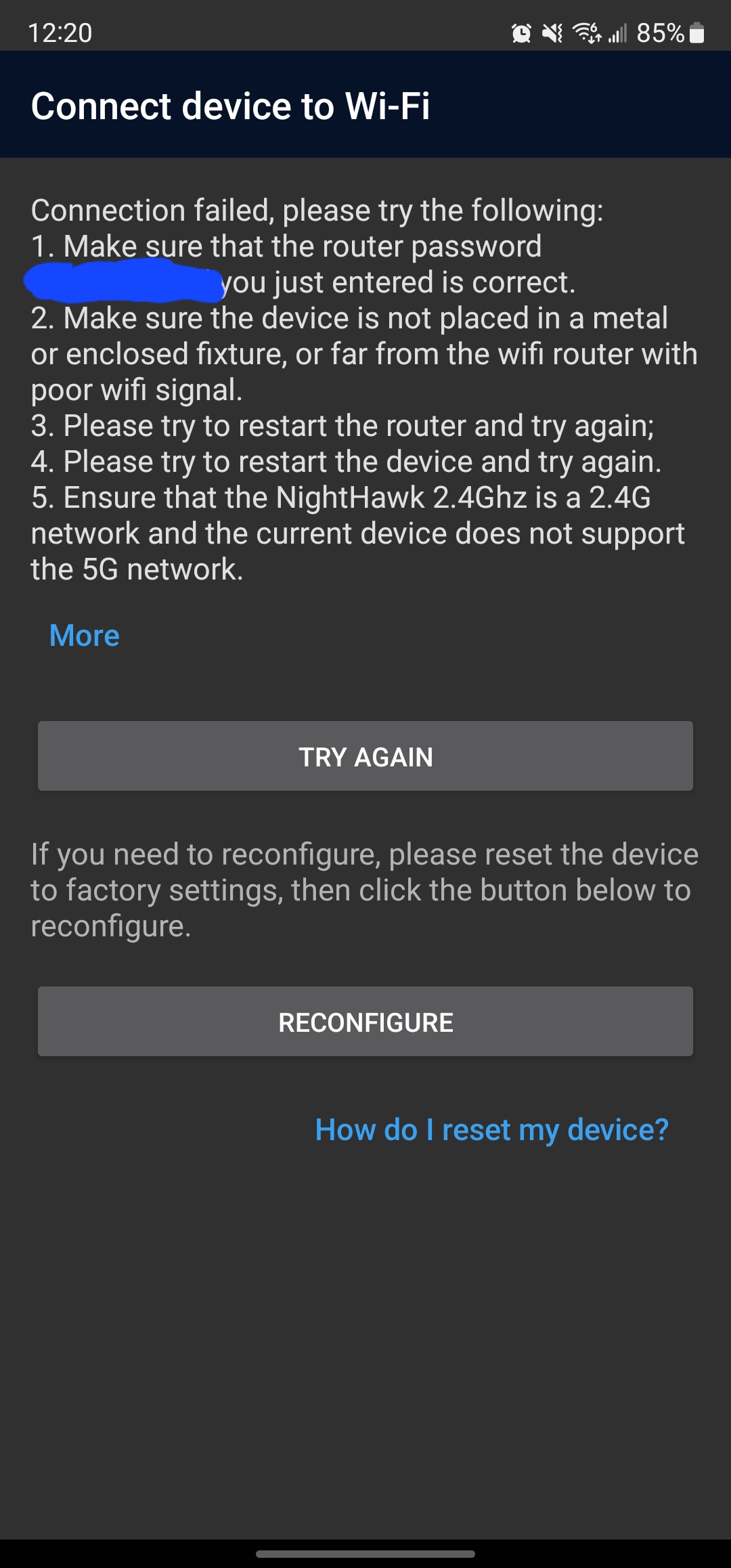

Would it be possible to get a screenshot of the failure on the app? I had some issues getting IoT devices connected as well, and typically the issue was not actually the Wi-Fi association but communication to the IoT upstream servers. Not saying it’s not related, simply trying to identify which part fails. Sounds similar since yours appear to associate and it’s possible they intentionally drop off because they can’t communicate with the upstream servers.
A screenshot of your SSID and overall settings could help as well.

See my image above. This is the error I get in app for the lights.
I disabled my firewalla - disabled my DNS filter and bypassed my firewall with the AP just plugged into my modem. The device doesn’t show that it tried connecting to the AP in the device list either.?
This was also with a 2.4ghz only SSID as suggested
