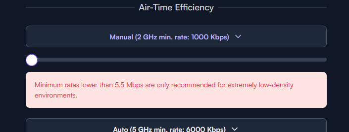

Any chance this is a WPA3 problem? Make absolutely sure WPA 3 and PMF are both off in ssid settings. Sorry if you have tried all of this already. Just trying to help brainstorm.

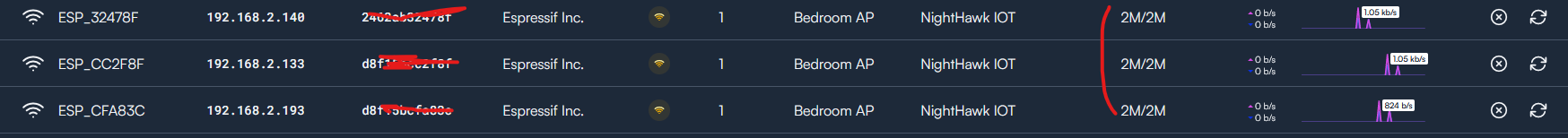

Matt helped me fix it, it ended up being the air-time efficiency for 2ghz was too high. We lowered that quite a bit and they connected right up. Thank-you everyone for the help!
When turning to auto it looks like the lowest is 11,000 kbps but the light strips wanted 2mbps or 2000kbps

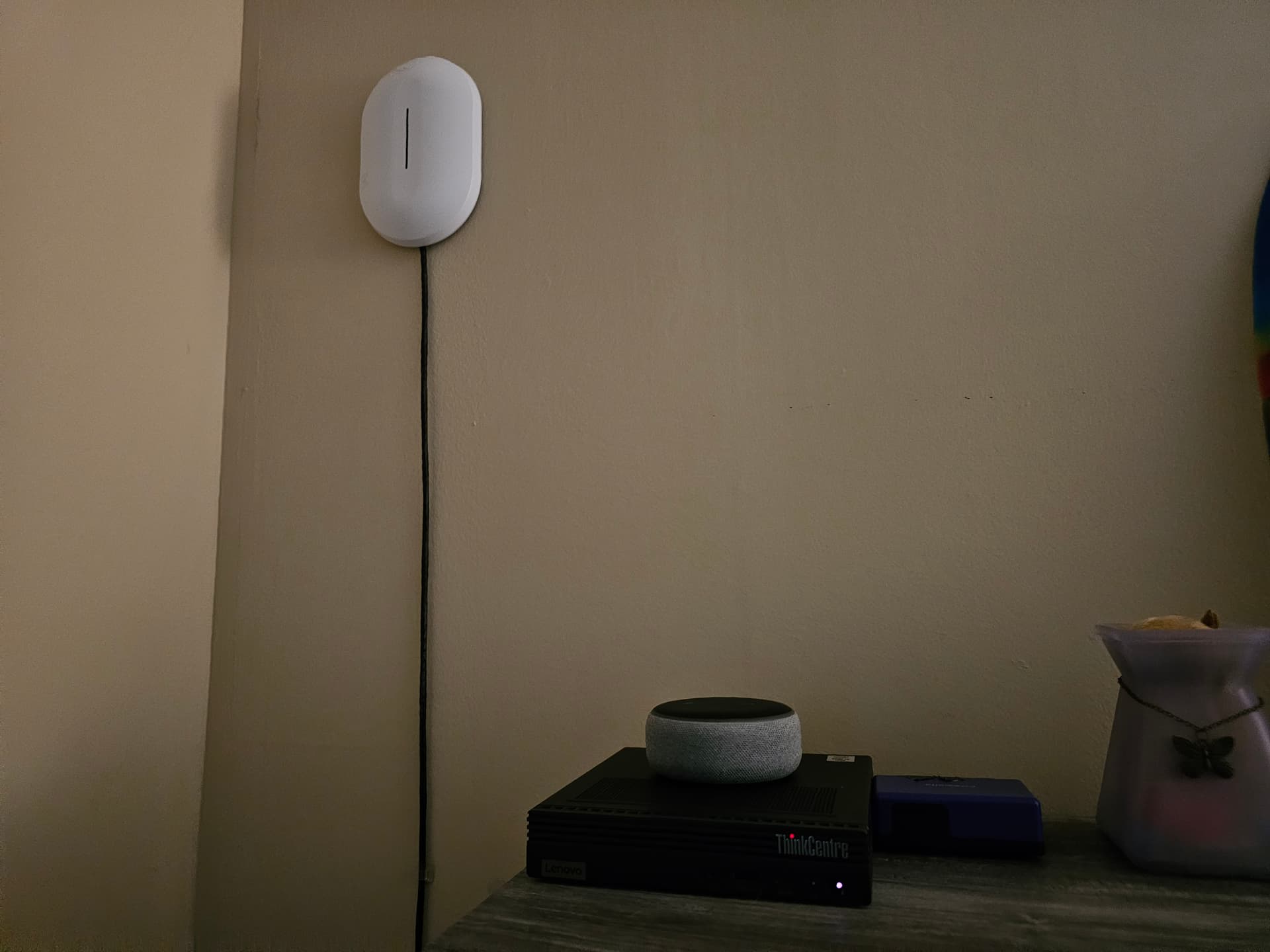

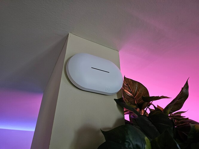

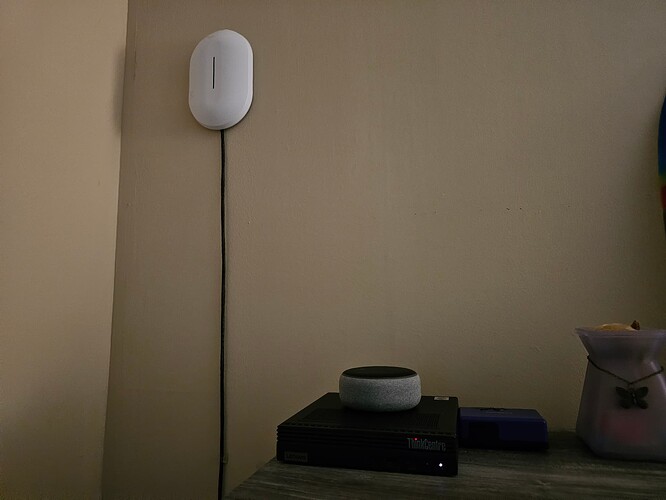

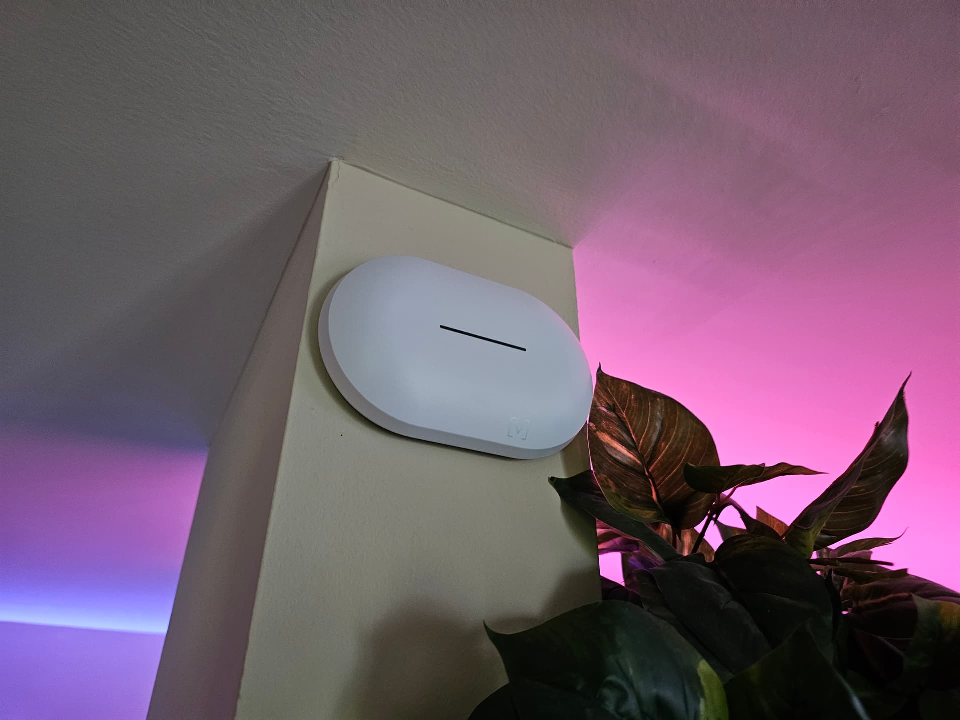

Mounted them to the wall!
