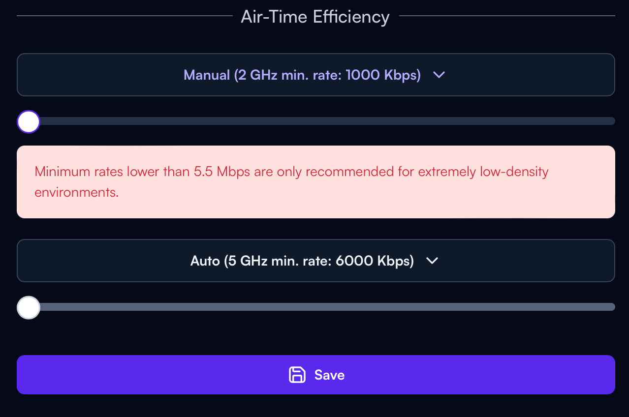

If you haven’t already, check your Air-Time Efficiency. For IoT, most users have had to turn 2.4Ghz all the way down as shown below,

This is what I had to do seems to be okay so far, sometimes they drop but not often. Mainly because they are little ESP devices.
