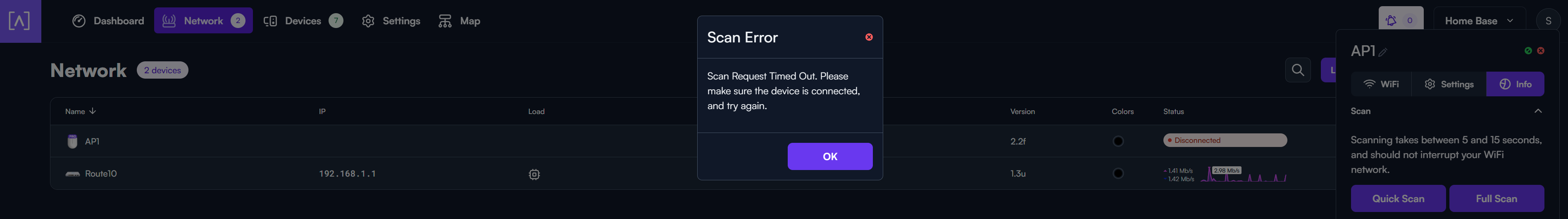

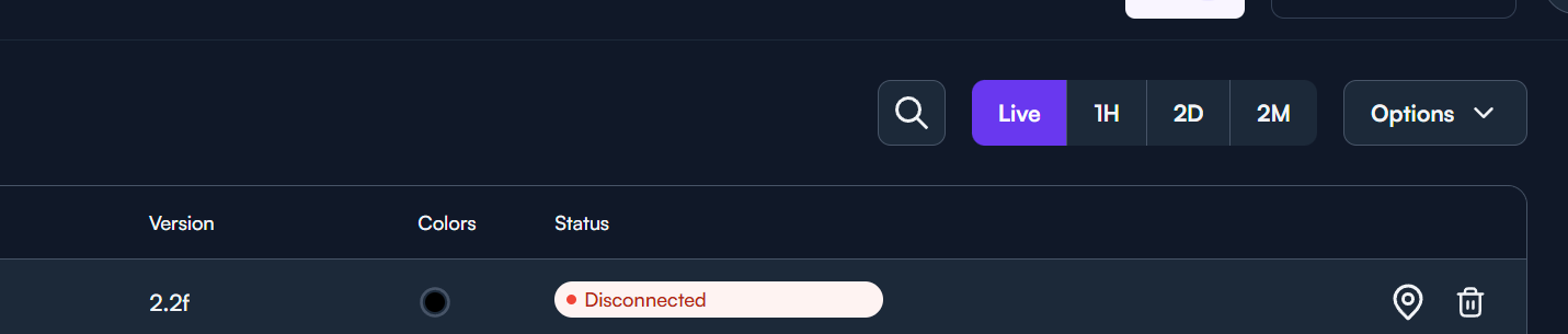

I actually started with only one AP6 Pro just to see if only one AP is enough, Im in the middle on configuring the the wifi, and I cannot understand why AP6 pro sometimes it says discconnected
whats more intereseting is running scan allways result in time out. Any idea whats happening in here?
I will have a look here in the morning, just realized its 00:28 in Sweden and I will be dead at work If I dont get some shut eye xD
maybe just try power cycling the route10 and ap6 together by unplugging the route10 (assuming the ap is connected to the poe port on the route10)?
Yes, the AP is connected to Route10 on PoE port
other things to check could be the other poe port, if its still dropping maybe try changing the ethernet cable.
