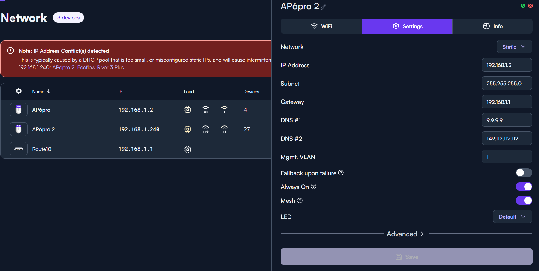

One of my AP6 Pros keep switching to DHCP even though I have fallback off and when doing so its creating an IP conflict. I’ve rebooted the AP and the route10 and it just keeps doing this over and over. I can go in set it back to 192.168.1.3 and it immediately reverts back to 192.168.1.240 and creates the conflict. It just started today from what I can tell.
Letting it go to DHCP and it moved to an IP without a conflict which at least stopped the alerts that the ap is unreachable. I don’t understand why all of a sudden its failing on 192.168.1.3, my dhcp pool starts at .100 and the only thing below that are statically assigned devices of which the 3 alta products occupy .1, .2, and .3 followed by the next closest device is .10.
If I change it back to static and set it to 192.168.1.3 it now fails back to the 192.168.1.241 it picked up after changing it to DHCP. Fallback is still off mind you.

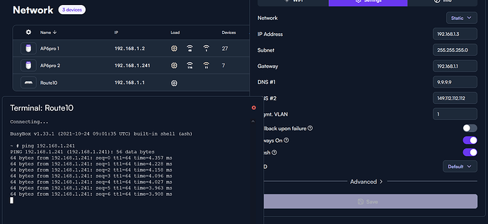

yeah setting to 192.168.1.3 and then pinging the new address it falls back to seems to confirm it is indeed falling back despite that option being turned off.

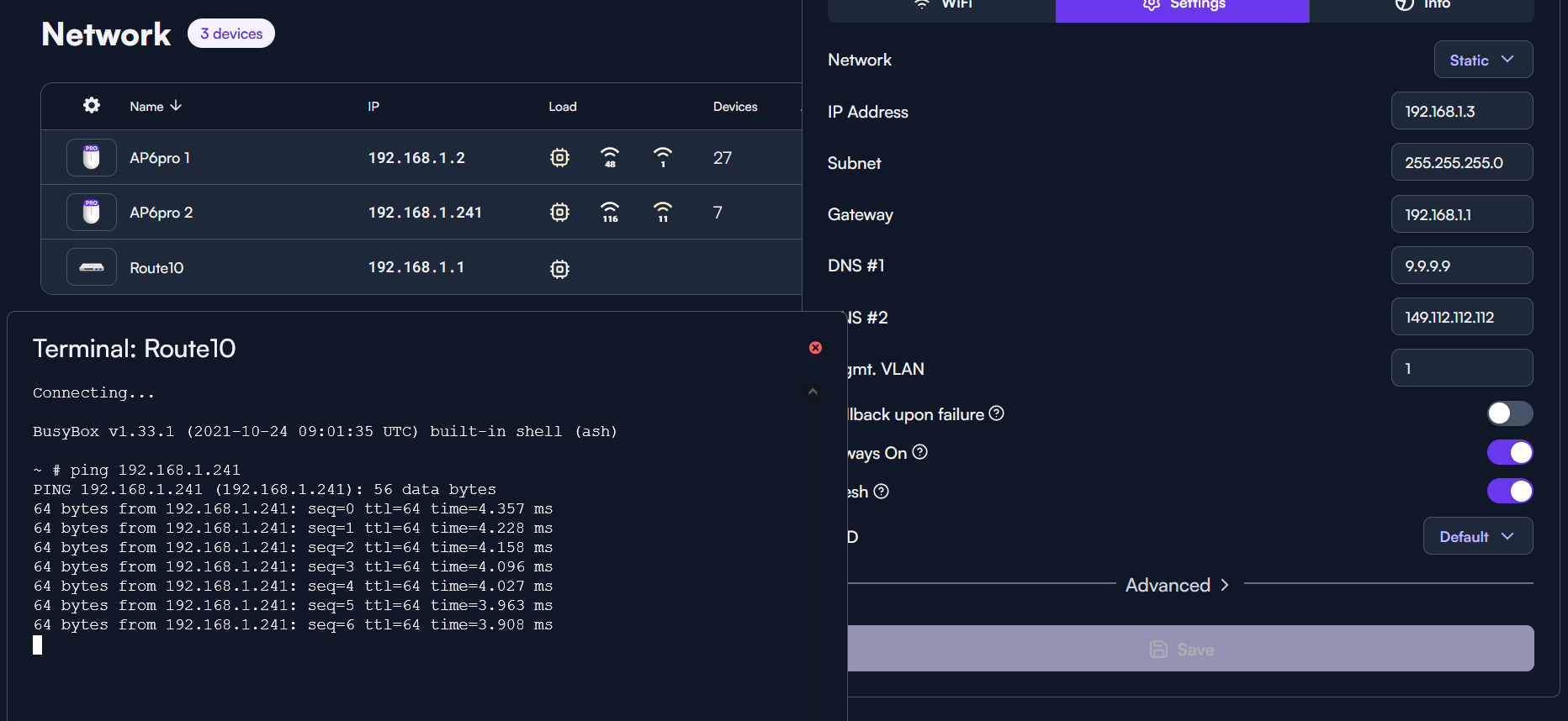

I disabled mesh, changed back to 192.168.1.3 (the ui keeps reverting it after the window closes), hit save, it changed back to .3 briefly then went back to .241, ping confirms its on 241.
The other AP is just fine, no issue, same with devices on the leg of the network. I can still remote into the pc thats connected to the same switch as the AP.
