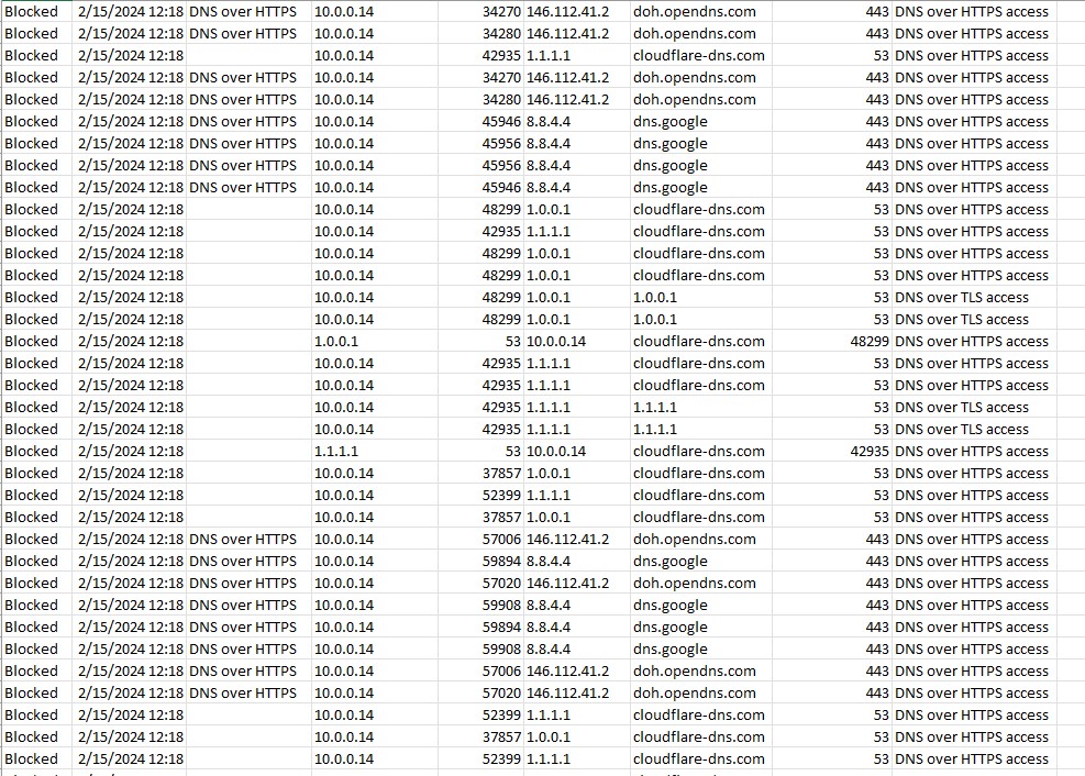

Not trying to be adversarial or anything here, but why do the APs work DNS so hard? They are reaching out to Cloudflare, Cisco and Google DNS rapid fire non-stop. I have internal DNS and prefer to use that. I added my internal DNS servers to the APs when I set them up, but they continue to hammer on the others mentioned above. I would very much like to disable this. As it is, I have blocked all but Cloudflare, because we use their ZeroTrust setup for several of our systems that remote workers need to access, and those are used extensively in the ZT setup. The internal DNS is pretty solid, so I don’t worry much about losing one of them (we have 3). Google DNS is a privacy issue, Cisco much the same, so can we please get the ability to disable these?

Pulling a report from my SIEM, it shows 64,410 attempts in the last hour for a single AP reaching out to Google DNS and OpenDNS (Cisco), this doesn’t include the Cloudflare DNS requests. That’s not insignificant. Now, it may be my fault it is so high, because I am blocking both of those and it may cause them to increase the attempts, but going back before the block was put in place, it was 55,340 in an hour from a single AP. So, in our location, we have 3 AP6-Pros, so multiply that by 3. It is actually 0 (zero) data because I am blocking it, but if I weren’t, it would be enough to set off alarms. My thoughts are: I understand the explanation, but I want the APs and switches to use the DNS servers I tell them to. I can’t tell you the number of times I have run an incident where data is being exfiltrated using DNS, either UDP or TCP and in the past couple of years, DOH, etc. I, perhaps suffer from a bit of professional paranoia, but it is what it is and I want to be in control of data and requests that leave networks I am responsible for. If you guys feel that strongly about using external DNS for this, pick one and use it, or give us a drop down list of them to choose from, because I don’t want any of my systems using Google DNS. Using all three of them and running through all of them for each request is not great. I want to repeat what I said in my first post, I am not trying to be adversarial, but I also don’t feel this is acceptable.

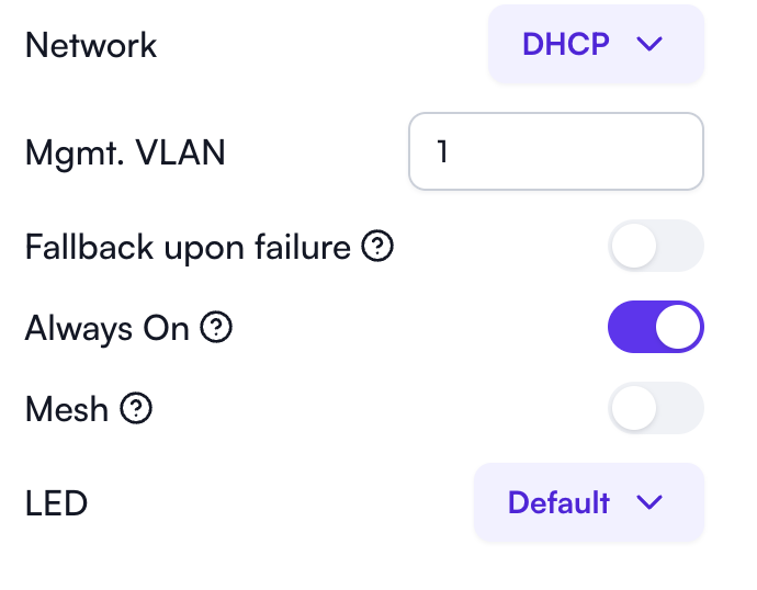

If you are truly concerned about these limited number of requests, you are free to disable the fallback-upon-failure and/or mesh features.
I have had that switched off on all APs and Switches for the past month or so …not concerned just more curious.
I have the APs set with static IP addresses with 2 local DNS servers set. I also turned off the “mesh” when I first installed them and last night, turned off the fallback on failure. I have been pretty busy today so haven’t looked at it yet, but have received alerts from our SOC about them again. I will ask them to do a count again and see where we are so far today.

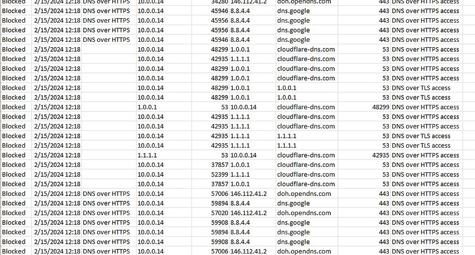

I don’t think the problem is the amount of times DNS is being queried to lookup ping.alta.inc and dl.alta.inc. It can do it every 30 seconds, I don’t care, but it needs to be using ONLY the DNS servers that are provided to it via DHCP or assigned statically.
Instead, the AP’s are using trying to use Google, OpenDNS and Cloudflare DNS servers to make the queries every 30 seconds, and each one of those requests also appears to try to use ports 53, 853 (DoT) and 443 (DoH) each time as well. That doesn’t bode well for security/privacy conscious users/businesses and each one will have their own reasons. This will fill up the firewall logs with “blocks” and set off alerts, as it should. Basically, the firewalls are doing their job and detecting a device on the network trying to use DNS servers other than the one’s assigned to it.
Do the Google, OpenDNS and Cloudflare DNS servers NEED to be used for some particular reason? If not, remove them because this problem is not going to go away for business users. And again, I’m have not seen this behavior on other manufacturer’s AP’s.
I’m attaching a little snippet of one of my logs so you can better understand what we’re seeing. (I don’t see a way to attach a CSV file but assume I can email you one if needed)
