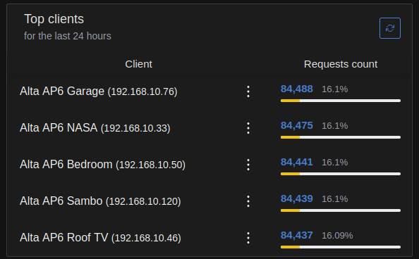

Am running a local controller and each of my 6 Alta AP’s does 1 DNS Query per Second!
This is way to much.
How can this be fixed/reduced/controlled?

Measured (tcpdump) to be axactly 1 request per second per AP.
And yes, that is too much.
Agree.
Yes, too frequent, about 30x too frequent.

I wonder if the Alta Team ever figured out whats really going on with those excessive DNS Requests. In my case, I still have 1 request to ping.alta.inc per second per AP, in my case, with 6 APs thats nearly half a million DNS requests per Day. Thats in my opinion unacceptable and holds me back recommending Alta - Although I really like those AP’s otherwise.
