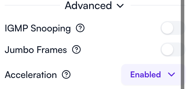

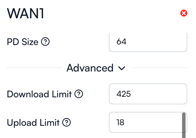

First thing is that I’m not sure if CAKE is functioning properly. I’ve had it set to the following bandwidth limits since the introduction of the feature:
with hardware acceleration enabled by default

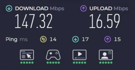

And I’ve generally been able to hit those speeds without issue when running various speedtests. Now I can’t seem to make it much pass 100-150Mbps on the download rate when running a speedtest from a device wired into the network. For example:

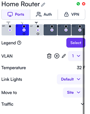

Second issue would be I noticed that the temperature of the router seems to be reporting a bit lower than previous:
I don’t recall precisely what the temperature was before, but I can definitely say it was higher than freezing. Router also hasn’t physically moved at all and the temp has only been going higher in my neck of the woods :wink:

Fwiw i have no issues maxing my 300mbps connection on rc5 (i dont use cake) and the temp is reporting 110f.
My temp is also reporting 32F on my route10
Have either of you rebooted after the firmware upgrade?
I have now. Temperature is reporting correctly again.
Haven’t rebooted it yet, although based on what @anon77415413 mentioned that will likely take care of the issue. It isn’t super important to me that it reports the correct temperature right this second though :slight_smile:

The post from @DN3092 reminded me that I should probably chime in real quick. Both the temp issue and CAKE performance issue seemed to resolve themselves upon a reboot. Seems to have been pretty smooth sailing since then.
