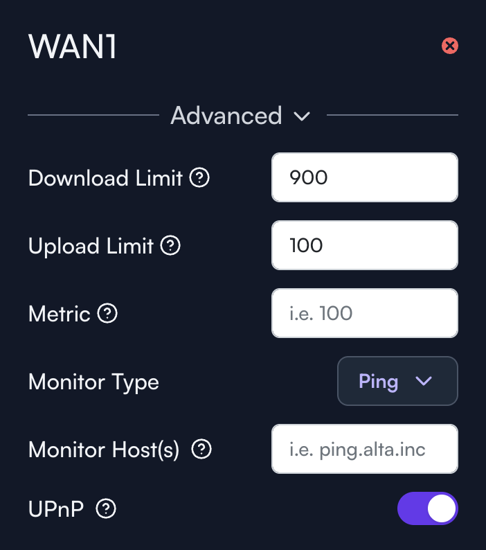

I’m on the latest firmware 1.4e and my WAN connection is PPPOE. I have tried the traffic shaping to eliminate buffer bloat and set my download limit to 900 and my upload limit to 100 it is significantly limiting my download speed to around the 500Mbps mark, with it off I’m hitting speeds of 930Mbps, but not seeing the same effect on the upload limit. Is this dramatic limiting on the download expected?
What happens if you change acceleration to disabled? Any change in download performance? It should automatically get disabled in the config when CAKE is enabled, so I’m not expecting much of a difference, but curious.
Network>Route10 Config>Ports>Advanced>Acceleration>Disabled.

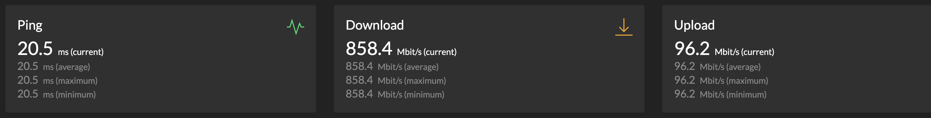

Hi Mike,
That does seem to have made a difference.
My speedtest server does a test every hour so I will see if I get roughly consistent speeds now with this setting, and report back.
Regards,
Ryan
