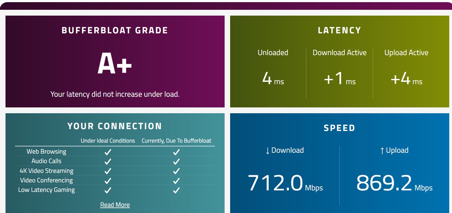

Yes. Disabling hardware acceleration took the download speed back up to around 750 from the 380-400 average. Does this effect anything else in terms of network performance by having hardware acceleration off?
Great. Now, try tuning again, as a trade-off between lower latency, speed reduction and CPU increase during high bandwidth usage.
I believe it is all about CPU usage, and if it becomes a bottleneck due to network complexity, it might be worth backing off on the limit or limits or switch back to hardware acceleration.
Thanks. Not bad at all after disabling acceleration!

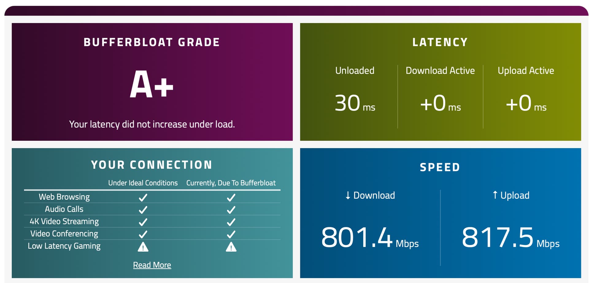

I did. Best settings for me are 900 down on limit setting and 950 upload limit. Keeps the latency low and also speeds are almost the same as previous tests. Any higher settings latency spikes and download speeds get lower. So the 10% down and 5% upload limits work well. Not bad at all. Acceleration is disabled. As soon as I enable it the download caps at 400ish.
I agree with, and can replicate your results. I have a bit higher unloaded latency due to my crappy usb-c to ethernet adapter.

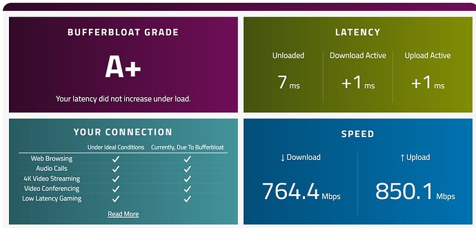

Below is a screenshot with Hardware Acceleration disabled, and cake set to 10% lower than my 940 X 940 symetrical fiber. If I leave everything else the same and re-enable Hardware Acceleration, my speeds drop to just over 400Mbps up and down.

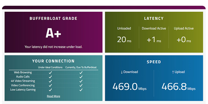

Figured I’d update this thread since I have a shiny new 500Mbps x 500Mbps fiber connection to play with.
That’s with the limits set to 500Mbps set in each direction. System load registers as ~33% although I haven’t really dug deep into it. Hardware acceleration is enabled as well.

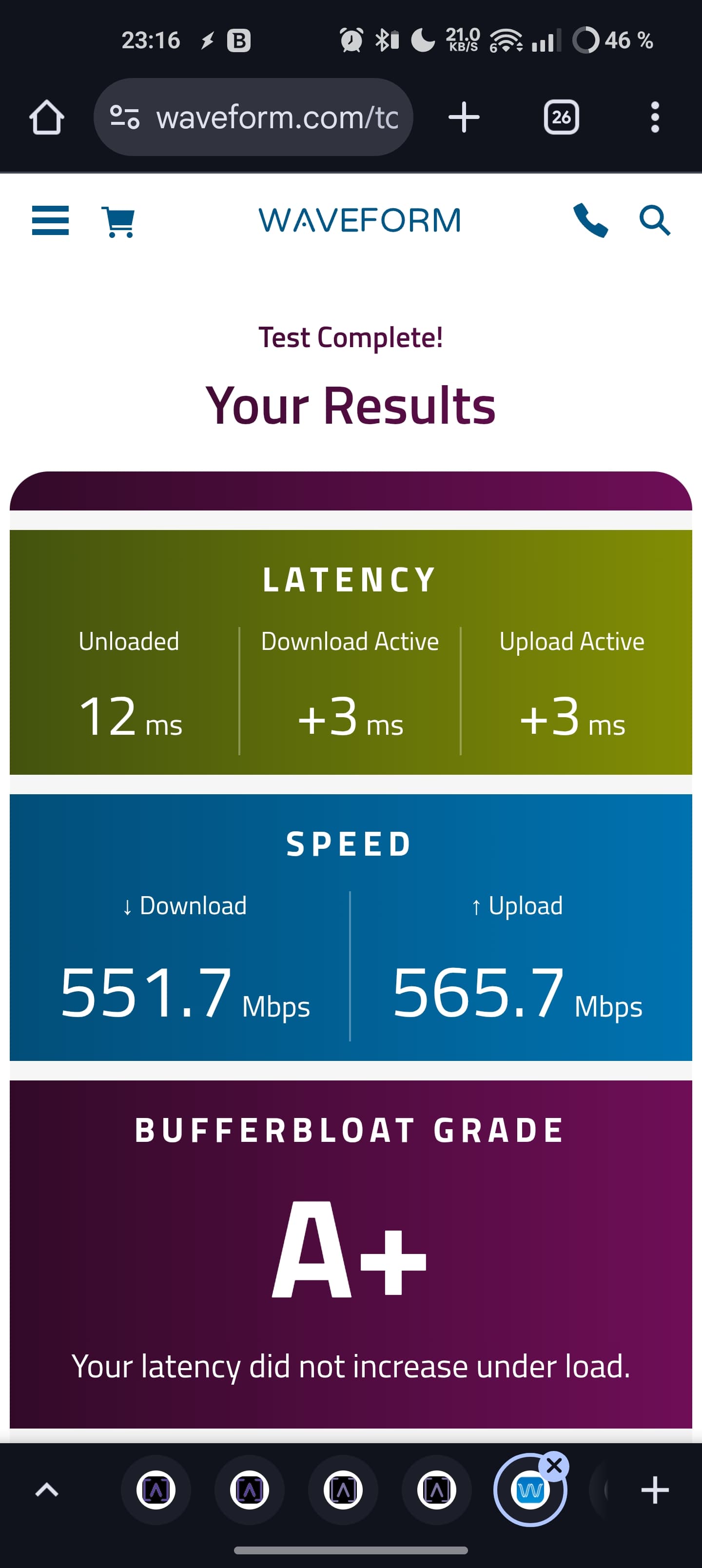

Adding my latest results too:
Nominal using Speedtest: 630/630 on a 600/600 subscription.
With CAKE limits set to 602/602 (95.5% of nominal), the results are:
Waveform:
A+, 12/+3/+3 via my Android device in room next to the AP6 Pro. System load is at 35-50 % up and 35 % down, for this type of test.
OpenSpeedTest: 580/560 (92/89% of nominal)
Speedtest: 560/570 (89/90 % of nominal)
System load is at 50-70 % down and 30-40 % up, for this type of test.
Very good indeed :+1::slightly_smiling_face:
