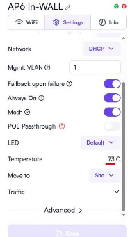

AP6W is very hot when running test, We need support and solutions
We are demoing the product for a 166 room hotel project. AP6W is very hot when running test, please check and support

Those are typical numbers for my ceiling mounted AP6 Pro as well. See here:
That is the temperature right at the CPU, which will be much hotter than the outer case temperature. Those values are completely normal.

I just published a 3D model for a stand with a fan that lowered my AP6W temp by 12°C:
