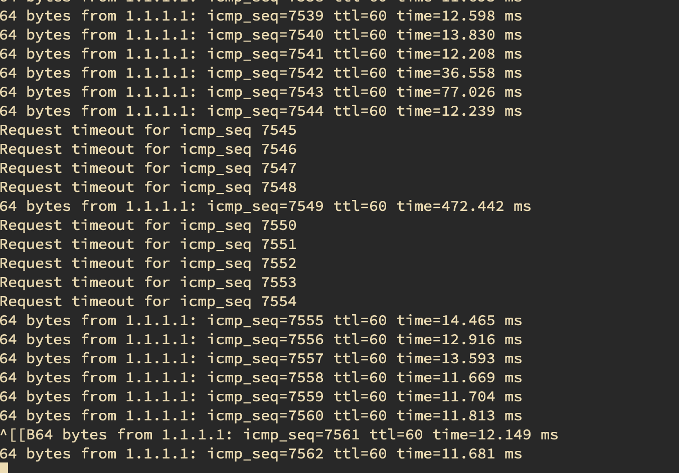

I have this problem om my macbook M3 Pro where it drops the wifi connection about every hour 60-70 minutes. the drops is about 10-15 seconds. and after that its perferct for 1 hour. this is my ping when it happens.
The rest of the time its perfect. so in about 1 hour it happens again. i timed it today between 2 drops and its about 70 minutes.

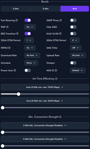

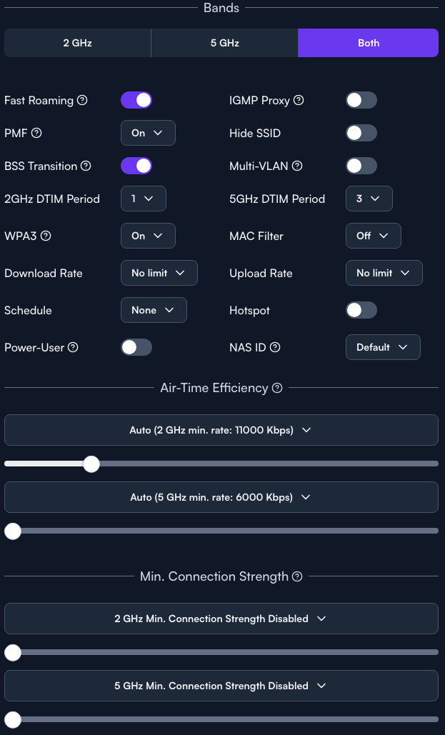

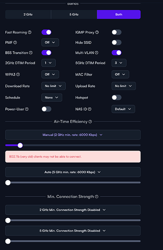

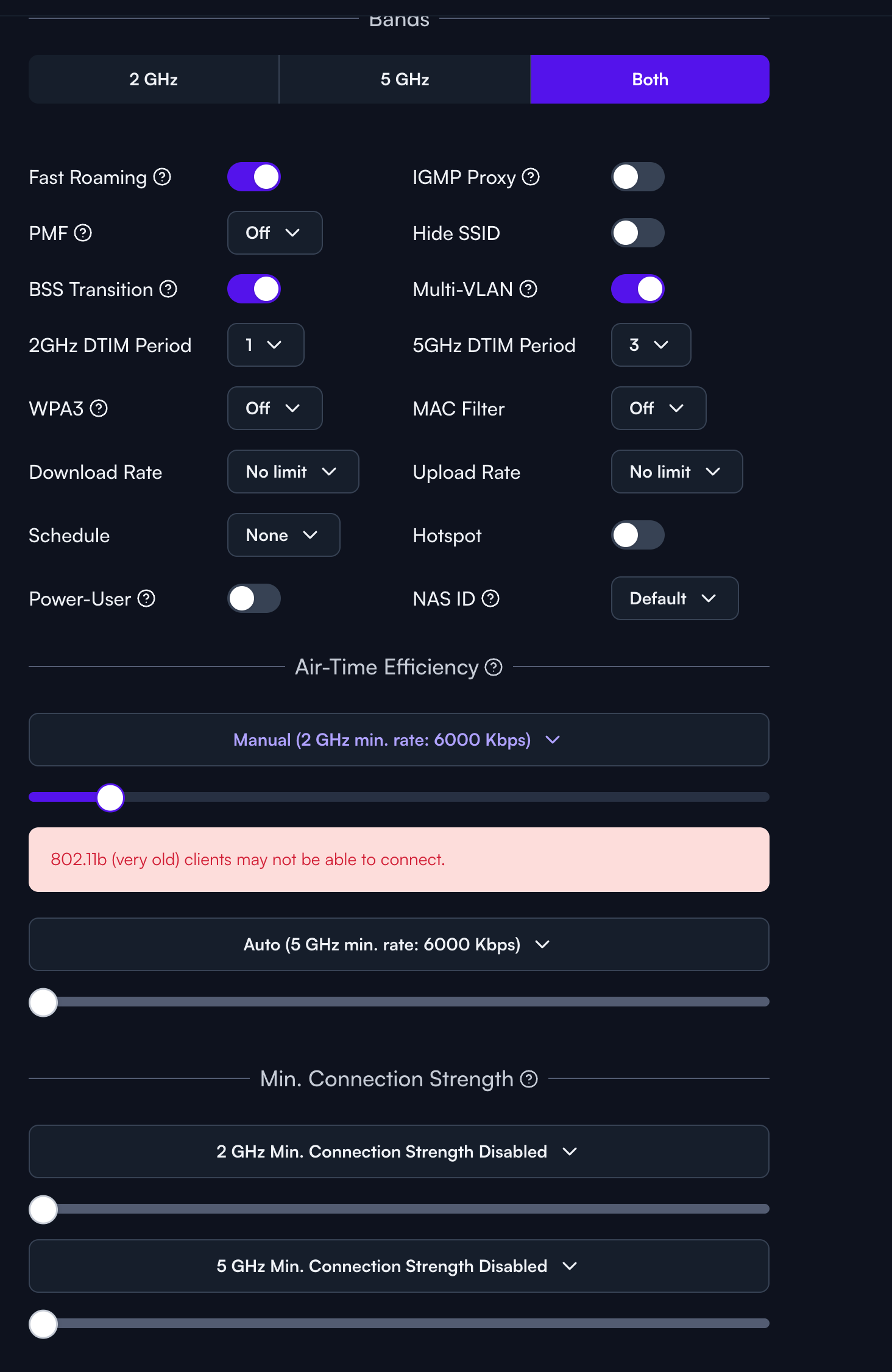

this is my settings on the wifi/ssid.
Anyone else having same problems with AP6/AP6-Pro and macbooks?
No issues for me. I also switched to WPA3 and enabled PMF this morning. Before that both were set to off. Pinging an external IP address isn’t a fair way to see if the issue is internal or external. I’d do a constant ping to an internal address and see if it drops out.
I did enable PFM and WPA3, stil the same issue.

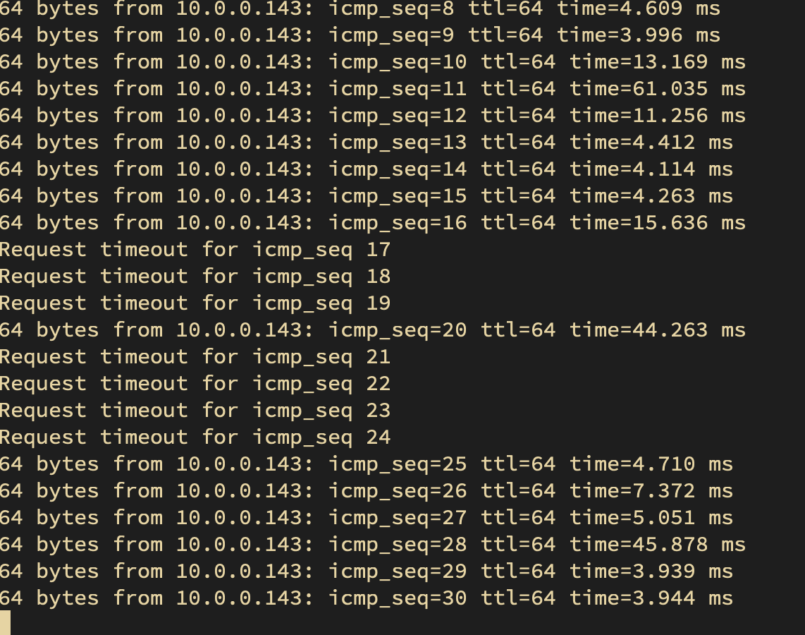

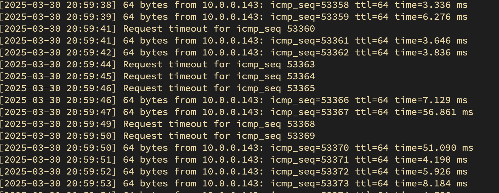

this time i ping the AP6 internal IP.

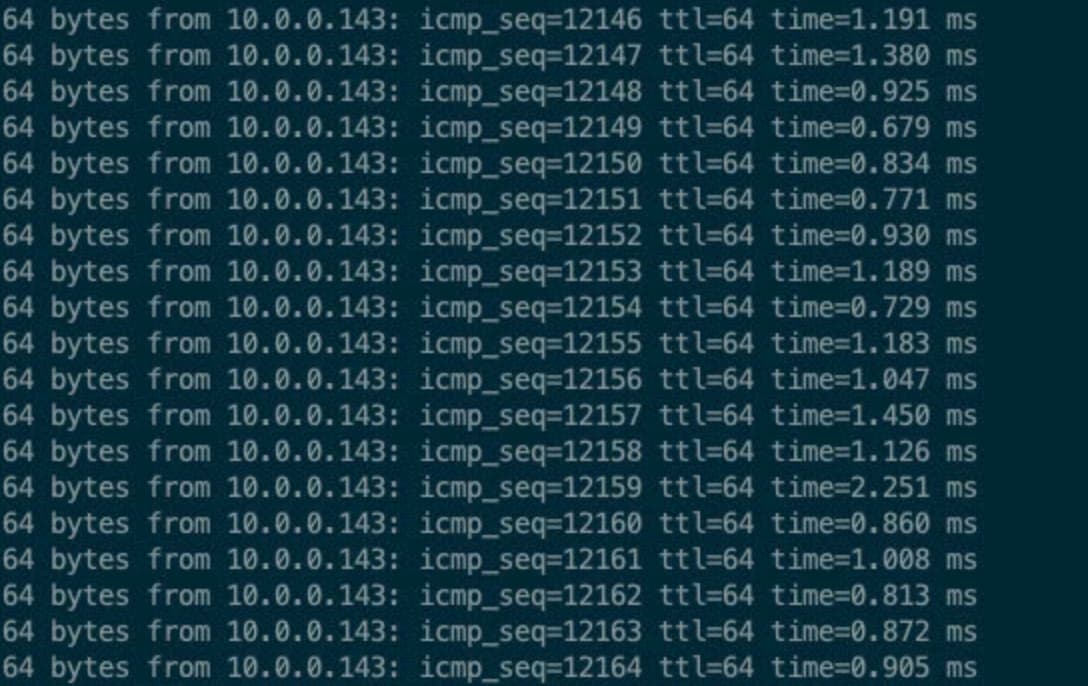

ping from wired computer at the exact same time.
so there must be some bug with the AP6.

So WPA2/3 mode, to truly be transition mode, depends on PMF being set as optional. If PMF is disabled, then you have a glorified WPA2-only network.
Before we exposed PMF provisioning we automatically set PMF to optional for transition mode even if the toggle was off, but that’s where the problem happened. Because the PMF toggle was disabled it actually disabled PMF at time of upgrade, which is why (profile sensitive) devices had problems reconnecting automatically.
Disabling transition mode obviously is one option, or switching PMF to optional should’ve also fixed the issue. Another way would’ve been deleting and rebuilding the profile on each client device, but then you also would’ve had a glorified WPA2-only network.

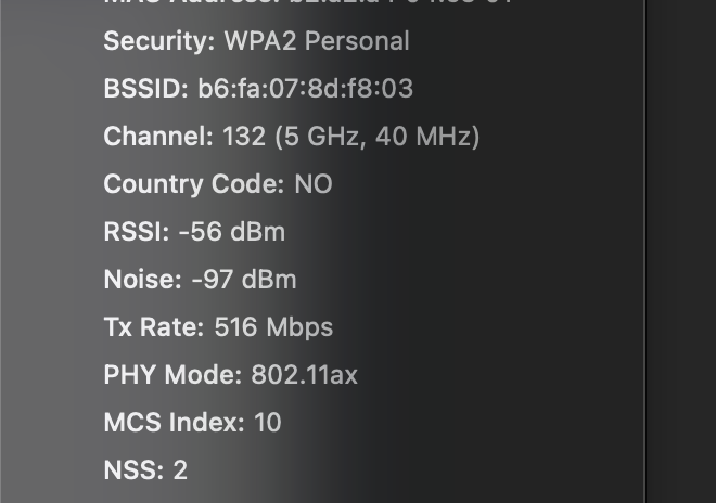

Have you checked the signal on the Mac at time of issue? If you hold option and click on the Wi-Fi icon up by the clock it should show you connection information. I realize this is receive and pings are transmit, but it’s a start. It would be great to see it at the Control side, too, but timing that may be challenging.

Here is my recent drop and from my mac pining the AP Im connected to.
Its the same time. just different time zones on the devices.
This is my mac signal strenght.

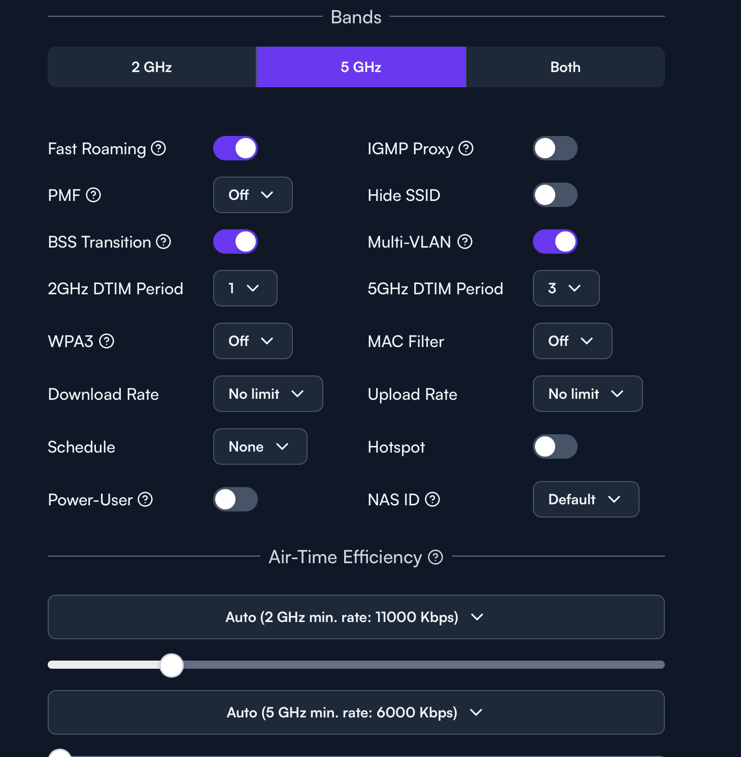

EDIT: I can already confirm that simply making a completely new SSID does NOT solve the problem. Here are the setting that are still causing my Apple devices to constantly disconnect and reconnect. They are basic as can be.

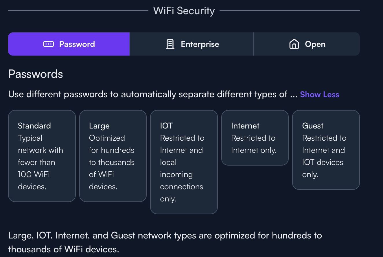

What networy type under WiFi security are you selecting? I’m using standard and I’m not seeing any issues.
Im doing the Standard on the SSID i have problems with.
I’m using standard, too. Not sure why you’re having issues.
Standard for me as well. I have sent log files to the team for further investigation.

Unfortunately I couldn’t tell that because the MAC of Wi-Fi interface on the MBP was trimmed from the screenshot. So I did make an assumption based on timing and what I saw. If it’s not logging anything on the AP, then the logs provided are not useful, simple as that.
If it’s not triggering logs on the AP, then we’ll need to lean on Wireless Diagnostics on the Mac so we can see what’s wrong from its perspective. There is a guide HERE on how to initiate that. Basically start it next time the issue is observed, and the we can look at the contents of the container that it generates.
