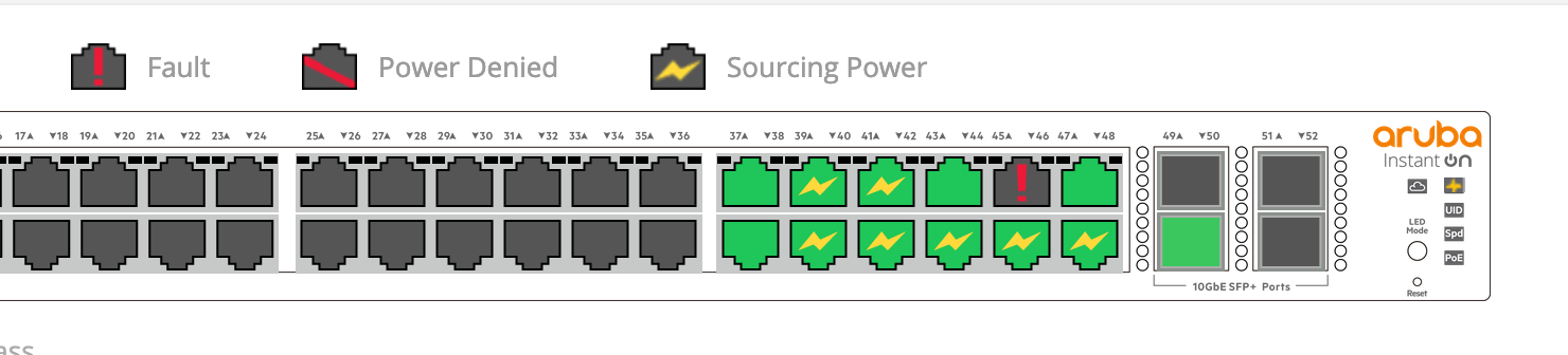

Unfortunately, I have another one I believe is dead…no reason either same thing is displayed on the switch as last time HP Aruba 1930 shows UNDERLOAD. Will have to get back to the site and see if it’s doing the same thing as last time (no lights on boot) @Byron-ISPSupplies can we start the RMA process I should be back there this weekend and can swap with one of the other extras I have.

yikessss 2 dead both indoors
