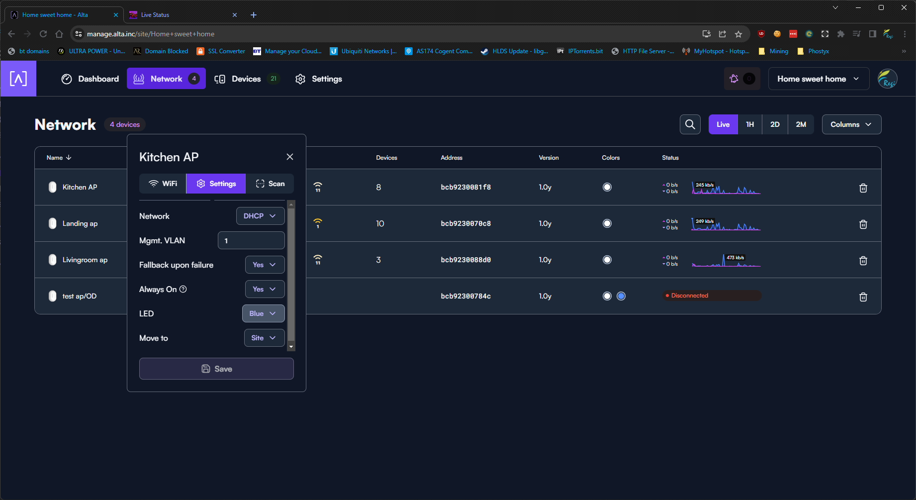

oh thats why starlink might be losing connection and by default the ap is set to not broadcast when no internet
Enabling this will keep WiFi broadcasting from this AP even if the Internet goes down.
Always On Yes but by default is No
i am also over starlink connection too as well as my fixed internet
hope this image helps looknig at my kitchen ap
Thanks @regchan! Curious to see if this fixes it too…
could this option be enabled by default always on feature
