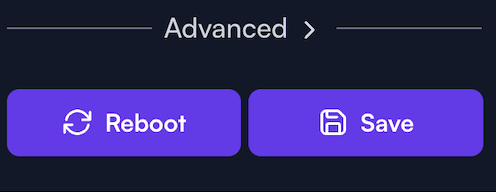

You can then reboot the device. Go to settings, scroll to where you see “Save” hold the shift key and “Reboot” will show up as an option. That should return the device to the static IP.

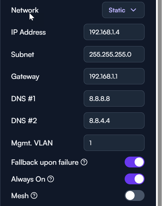

OK I have tried to unselect the fallback solution and reset the AP device and I also tried to turn off POE ad restart the device in this way.
I still get the same

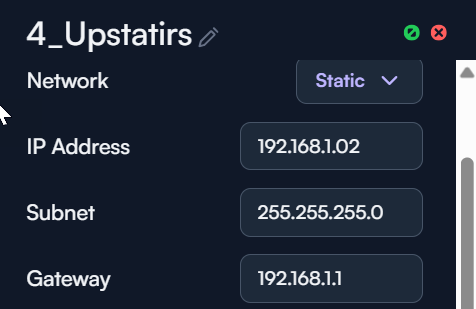

This is the overview
And the detail device I try to configure

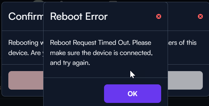

And what I get when I reset the device.

I understand the fallbck solution and I have turned that off for the device. But it really does not mak any difference at all if on or off it does exactly the same.

Also I see you have .02 vs .2. I don’t know if it matters, maybe worth changing that to .2.
I’m having the same issue here, fallback is off yet it does it anyway.
I’m honestly wondering if you’re hitting a caching issue, which is compounding this for you. Either by rendering the wrong IPs at times, and/or causing it not to provision as expected, or both.

My DHCP range is from 11 to 254 so I have reserved a few addresses for the Alta Equipment.
I have tried all possible numbers .2, .02 and even .002 but nothing help.
I also tried with .4, .04 but also this does not help.
