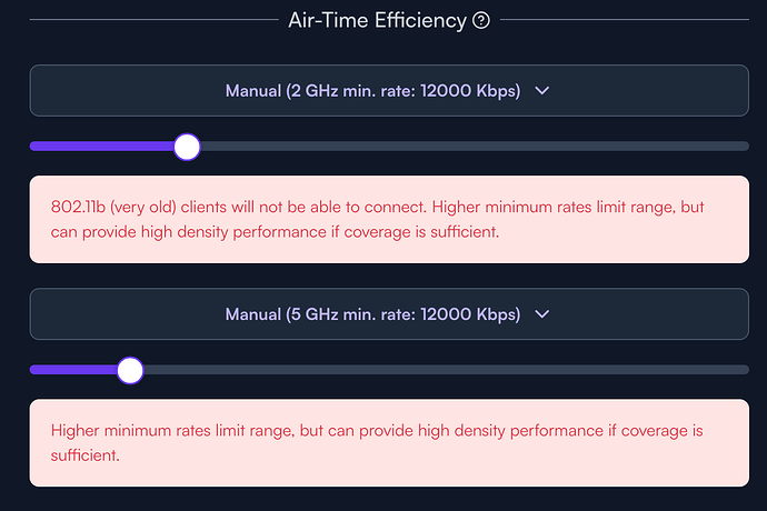

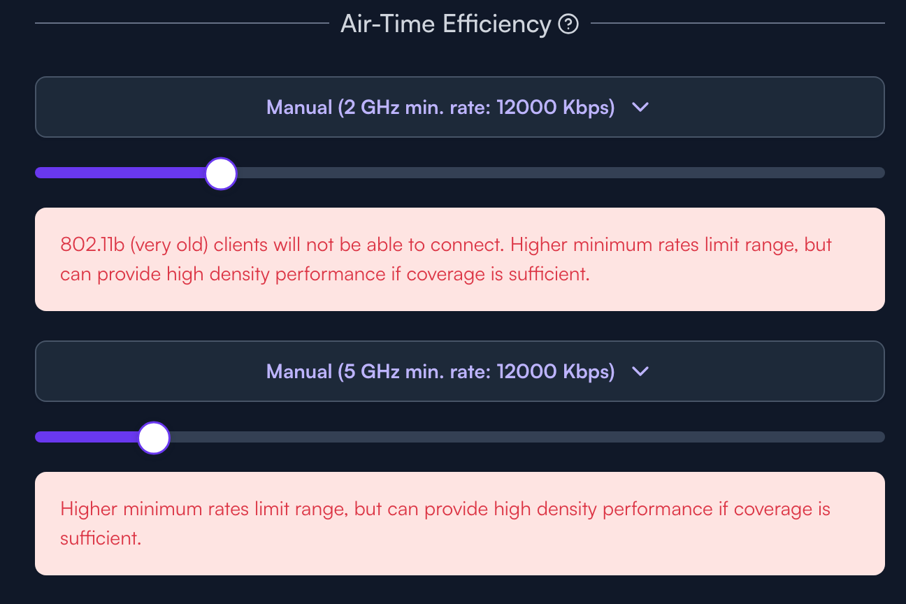

Just wanted to report a potential issue! Not sure if this is related to the firmware update, but I was testing out some settings at a site and I appear to be unable to set Air Effenciency in an SSID back to auto after tweaking them.
Seeing that behavior accross a couple of differnt sites, although I already updated them to the latest AP firmware so I can’t confirm if it’s firmware or controller related specifically.
Thanks! Checked and can confirm the same. I don’t think it’s specific to this firmware, but we’ll get this fixed. Thanks for reporting!
@jmszuch the issue with being unable to revert to auto has been resolved on cloud, and will be available in the next local tag.
Thanks @Alta-MikeD ! I’ll be sure to check it out when I have a moment.
Just wanted to pop back in and confirm reverting to auto is working as expected. Thanks again!
