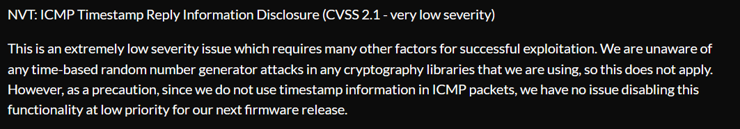

As for the focus on security, I think publishing of vulnerabilities and security updates has been requested numerous times in the forums too, however all I have seen acknowledging vulnerabilties is this post CVE vulnerabilities router10 and controller - #6 by Alta-Jeff from May, in which the one security vulnerability that was accepted …
Was going to be “disabling this functionality at low priority for our next firmware release.”

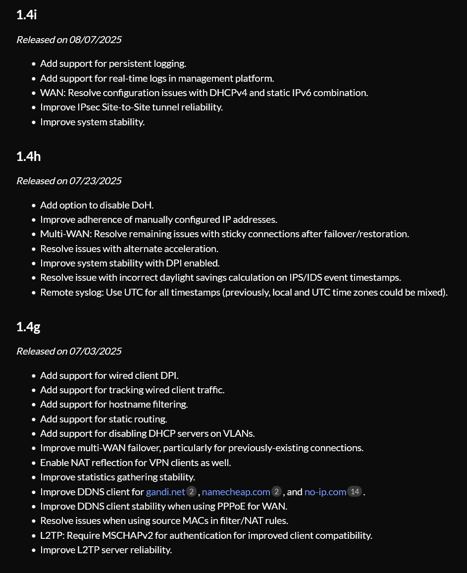

There have been 3 route10 releases since then, none of which mentioned that…

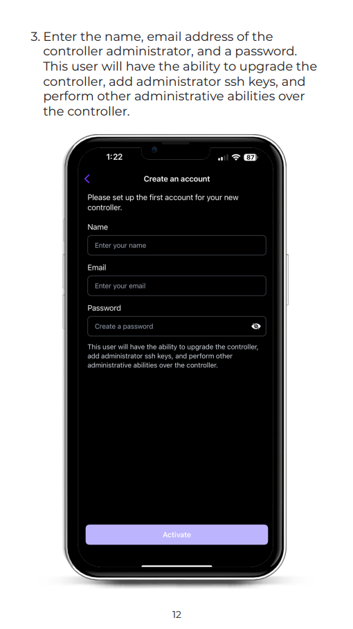

Additionally, the QR code provided in the quick set up lists SSH as an “option”, nothing of mandatory requirements in the likelihood things go astray or end users happened to be bricked out of their devices. Users are expecting both the device and UI to function and provide similar features that are generally available in the market today. They should not have to worry that when something goes wrong, they need to download putty at the minimum and start tinkering within the syntax to correct anomalies.
By the way, the quick start guide for Alta’s Control on your website points to the S8 documentation download.

We did disable ICMP Timestamp replies on the Route10 firmware in 1.4g, but did not deem it a high enough security risk to mention in release notes. CVSS score of 2.1 is very low severity, by definition.

And thank you for pointing out the incorrect Control QSG link!
