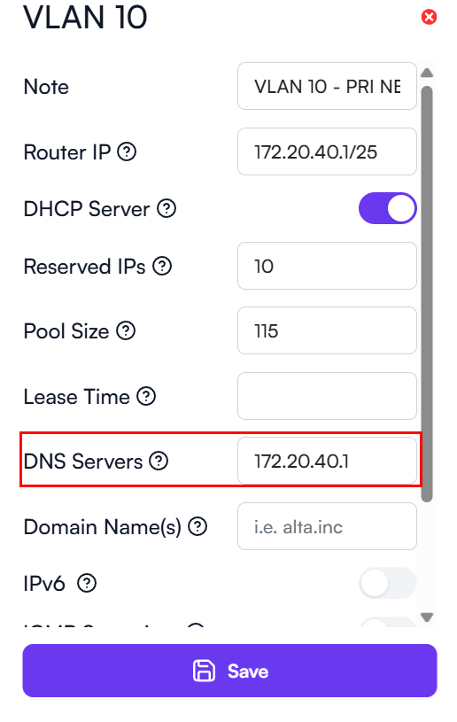

Yes, I’m quite aware. Now enter a second entry and pull your WAN connection on an R10 interface in a locally controlled environment and see if you can access your Alta Control/Controller. In that case, there should be an alert raised cautioning against secondary entries if it breaks local access.
With a static set only to the default gateway, you retain local Control access without an active ISP connection. But if you set a secondary, it will time out. Clearly there is some form of a metric based mechanism in place that senses a severed connection over the static gateway and reverts to the next DNS for resolution if computed, but in a locally controlled environment, this needs to be considered.

“With a static set only to the default gateway, you retain local Control access without an active ISP connection. But if you set a secondary, it will time out.”
