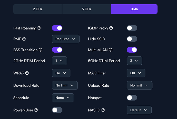

Trying to figure out if I need to change a setting but I have WPA3 on with PMF on and some devices are having connectivity issues unless I disable WPA3
It’s mainly a MyQ garage door opener and a few Lifx bulbs and some eufy gear
Was using unifi APs previously so unsure of why it’s not connecting when WPA3 was enabled before but it was set to WPA2/3 transition mode.
Anyone got it working so far since debating putting up a Unifi AP again just to get IoT stuff working

I have tried with a new SSID as well and the same issue occurs. The only temp workaround is to disable WPA3 but this shouldn’t be a workaround as I previously had a WPA3 network before in WPA2/WPA3 personal transition mode and all devices worked fine.
Thanks. Can you confirm that you set the values to required instead of on?
Yes these are the settings on my side
Seems like PMF is Required while WPA3 is On, i.e. optional. So, clients connecting with WPA2 but not able to handle PMF will fail? PMF might also need to be set to On?!
Yes, you might be on to something there @ebuckland81 . If I’m understanding properly, setting both PMF and WPA3 to on enables WPA2/WPA3 transition mode whereas setting both to Required gets you WPA3 only. There could be some weirdness with having PMF set to required and WPA3 set to on. That all being said, I do wish there was some more clarity in the interface about what options need to be set to have the effect you want.

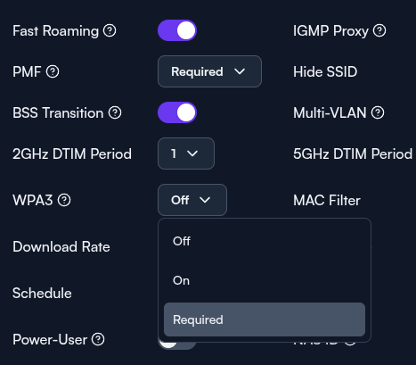

Could you set the WPA3 value also?
Thanks! didn’t know that a terminal interface is available via the webUI
Thanks I have tried WPA3 Required and it ended up dropping all of my IoT devices off the network. What I did notice is that with WPA3 required and PMF on all of the normal devices that support WPA3 Personal connect fine but it seems that the issue is related to WPA3 on and PMF on.
