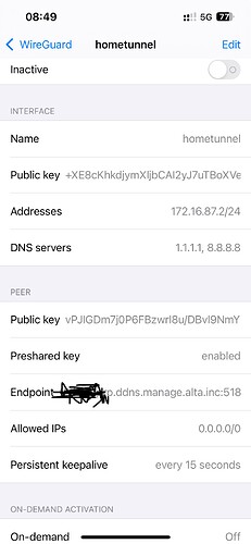

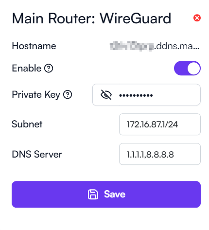

Can you confirm the configuration on your client device appears correct also? Which instruction did you follow? Was it in our help center?
i used the instruction from the help center to setup! for the client config, i just scanned the QR code! here are screenshots

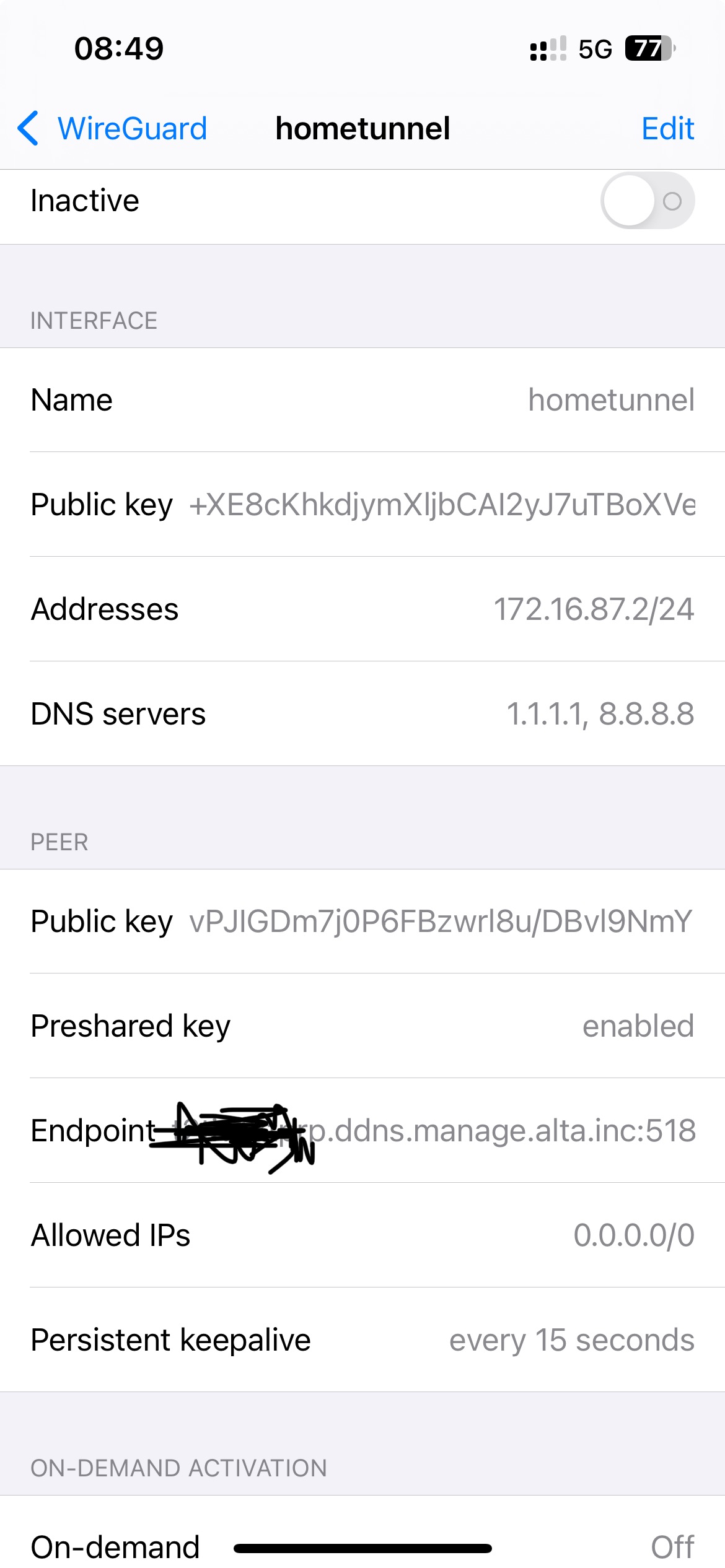

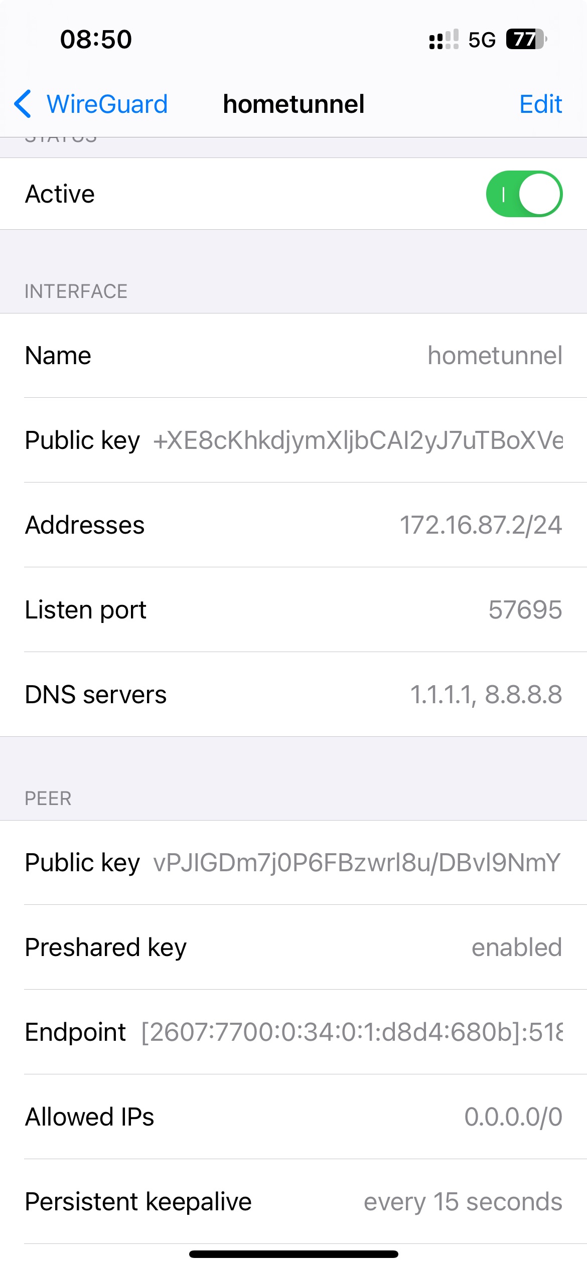

One thing i noticed on the client when i view the config when VPN is not enabled it is showing endpoint name in: ddns but when it is active is showing Peer Endpoint IPv6. Not sure if that helps;
I don’t understand what you’re stating here. Can you screenshot the two different states?
Also, could you try a different browser when viewing the QR code from your desktop or laptop?
sure i will try different browser:
Look at the two client config screenshot i posted above and look for EndPoint line when VPN/tunnel it is in active state vs inactive state the Endpoint Line changes ddns to IPv6 address! maybe just a nuance but that is noticed on the client configuration on my phone! Make sense?
My brain did not register these two screenshots the first time around, woops! I see what you mean now.
When you activate the tunnel, you see the IPv6 instead of the ddns.

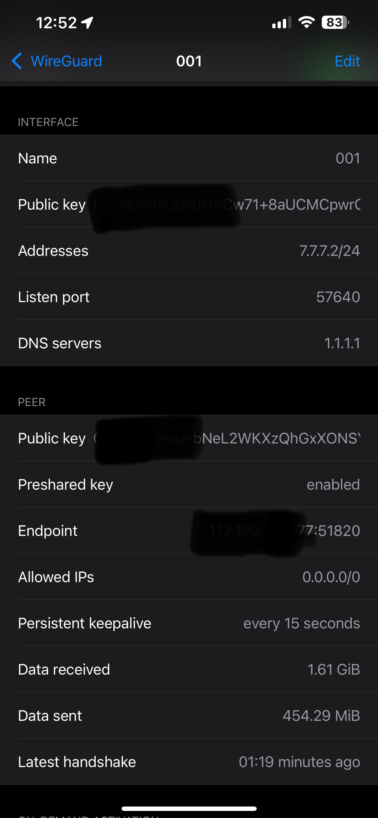

i also facing the same issue, i can setup the profile and can establish connect from my iphone wireguard app to route10 wireguard.
but i noticed that the Data received is very very low, like in Bytes, where as the Data sent in is in 10-20KB.
so i have tested with my other router (Flint2)Wireguard server with the same ISP and i am able to connect my iphone and able to connect to my home network via 5G network.
did i miss a config somewhere(DDNS?keys? ip? vlan?)? as i follow this guide https://help.alta.inc/hc/en-us/articles/32440809238171-Configuring-WireGuard-Remote-User-VPN-on-Route10 . My route10 is on 1.3v .
using the Wan2 port to connect to my 2.5GB ISP (not sure if wan port makes any differences?)
Thanks.
Could you clarify if this means that you tested the throughput with a speedtest tool and the result was in bytes and kilobytes?
Hi @Alta-Josh , thanks for getting back to me. Not sure if it needs more time or it work after I reboot again. WireGuard is working now.
Sorry for not being clear on the data provided. I have attached a screenshot of the WireGuard of my iPhone. I was pointing to the data send and receive in my WireGuard page. Now it looks way better. Just could get it working last night . Try to troubleshoot till 2am but was not getting any results. Could be doing something wrong hahaha.
Did some Speedtest on my desktops n iPhone. It is working I can access my nas on 5G too.

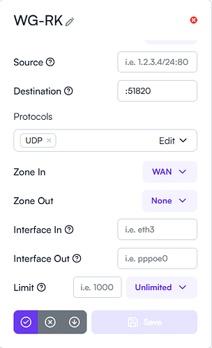

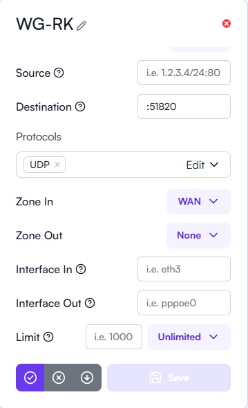

Hi,
I don’t want to open a new thread because my problem is related to this one.
I also configured Wireguard, scanned the QR on my phone and… it didn’t work, I checked whether an exception for the Wireguard server port was added to the firewall and it wasn’t there. I would like to emphasize that I did not restart the device, after manually adding an exception for the Wirteguard server port, the connection worked. Now the questions :slight_smile: :
  1. Is this normal? If so and you need to add an exception manually, it may be worth adding this information to the Wireguard Setup manual.
  2. If this is not normal and you need to restart the Router after enabling Wireguard, I would also add such information to the Configuration Instructions.
    2.1 If turning on the Wireguard Server should add an exception to the firewall and as we can see it does not - then we probably have a bug.
    Controller: Local version 1.0t
    Router: 1.3v
Thank you for your attention
A new thread would be warranted, since there may be no issue in this thread at all for yours to be related to. However, I can split that out on your behalf if we determine that to be the case, so no worries.
Can you consistently reproduce this issue? Please confirm your WireGuard client config (from downloading it or the QR code) appears correct first. Second, could you try scanning the code from a different web browser? I had a brief issue with a chromium-based browser, but it has since been resolved by the browser.
How was it that you created the firewall rule manually? What does that rule look like? Finally, how did you check for the WireGuard exception in the first place?

Can I reproduce the problem? Yes and no. I can if I delete this rule from Firewall → Filter
I created the rule manually and the connection was established, apart from adding the rule I did not make any changes. I did it based on my previous Mikrotik but rather for testing, because I did not know if the exception for the port used by Wireguard was created automatically, hence my questions in the previous post.

FYI - Solution to my original thread! it looks like i messed up private key field somewhat in the WireGuard setup section. In the logs i was able to see it
" Key is not the correct length or format" error and updated the key with the correct format. Now I am able to connect it.
Thank you for the help!
