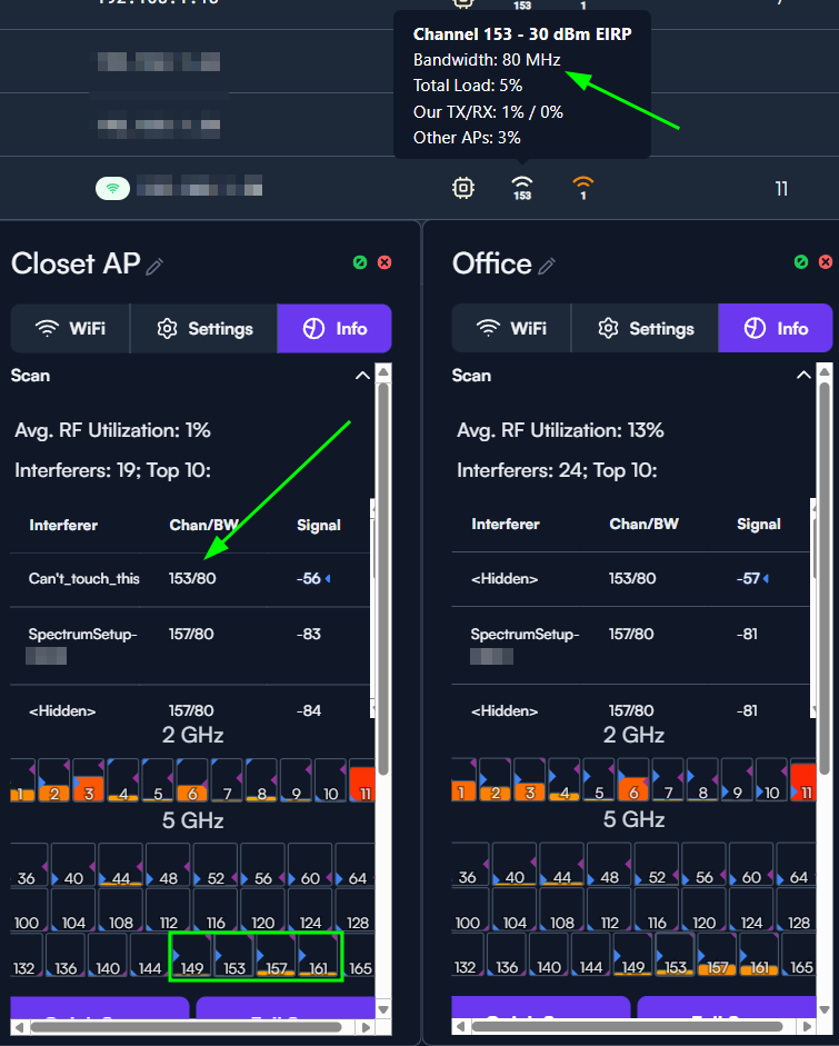

Ok, this is one of those “a picture is worth a thousand words” situations.
Let’s review your scans (I feel like a doctor typing that). I hope I blurred all sensitive information.
As we can see from the popup in the upper 20% of the screenshot, the AP is doing 30dBm EIRP (power transmitted) on channel 153 at 80MHz wide channels.
Given that this AP is meshed to the other AP, we know that upstream AP must be operating at channel 153 as well, which isn’t shown in the screenshot, but I can confirm; plus it’s required that meshed APs follow its upstream AP’s 5GHz channel.
Now, since 5GHz channels are 20MHz wide (this is why channels 150-152 aren’t shown), we know that the AP is taking up 4 channels (80 / 20 = 4). That will look something like the green box drawn at the bottom.
At the time this screenshot is taken, there’s also a Spectrum device doing the exact same thing. Channel 153 @ 80MHz. Granted, it’s seen at -83, but that’s still enough noise to mess with your day.

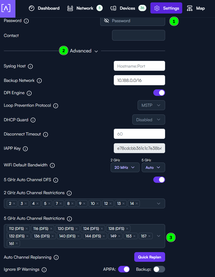

  • Exclude channels that interfere from the Auto mechanism
  • Statically set the upstream AP’s channel

Not so fast. The problem here is interference which you may or may not have control over.
If you don’t have control over that Spectrum device (i.e. it’s a neighbor’s device), then the short explanation is there’s nothing that can be done. Why? Because it’s a fairly safe bet from industry standards as well as the fact that we’ve been down this road before that it’s set to Auto channel selection and the widest channel width the hardware can do. This means that every time it reboots, the channel it chooses will be random (but theoretically the least interfered with channel).
Now you’d think that it would see your APs same as your APs are seeing it and avoid those channels, right? That’s a negative, ghost rider. Unfortunately, Auto is historically a terrible choice. Most “Auto” mechanisms are absolutely garbage, in my experience.
So let’s say we excluded the channels as shown in the screenshot so the Alta APs don’t use them. The next time that Spectrum device reboots, it may choose another channel which means 149-161 are now free to use, but it may stomp on the channel(s) the APs are currently using.
The best solution
Kill that Spectrum device if possible. If it’s provided to you by your ISP, it should be as easy as disabling WiFi.
If that’s not an option (i.e. it’s not under your control), then there’s not much that can be done, unfortunately.
The good news is Alta’s auto mechanism doesn’t just run at boot, it runs at boot + the middle of the night, daily. So if necessary, the APs will switch channels in the middle of the night to avoid interference. In this case, either:
  1. The threshold to switch channels hasn’t been tripped, which is understandable
  2. The Spectrum device has gone to channel 153 between intervals
Additionally, it appears the APs are a bit too close together. Ideally you’d want them to see each other between -60 and -70, but they’re seeing each other at -56 and -57, respectively. In this case, it works to your advantage due to the higher noise/interference. The 5GHz power can always be tweaked to reduce that overlap. Just a secondary thing that I noticed.
