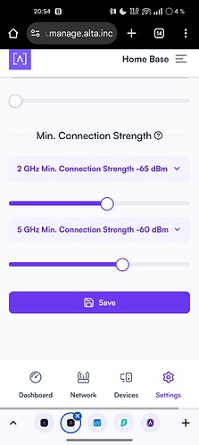

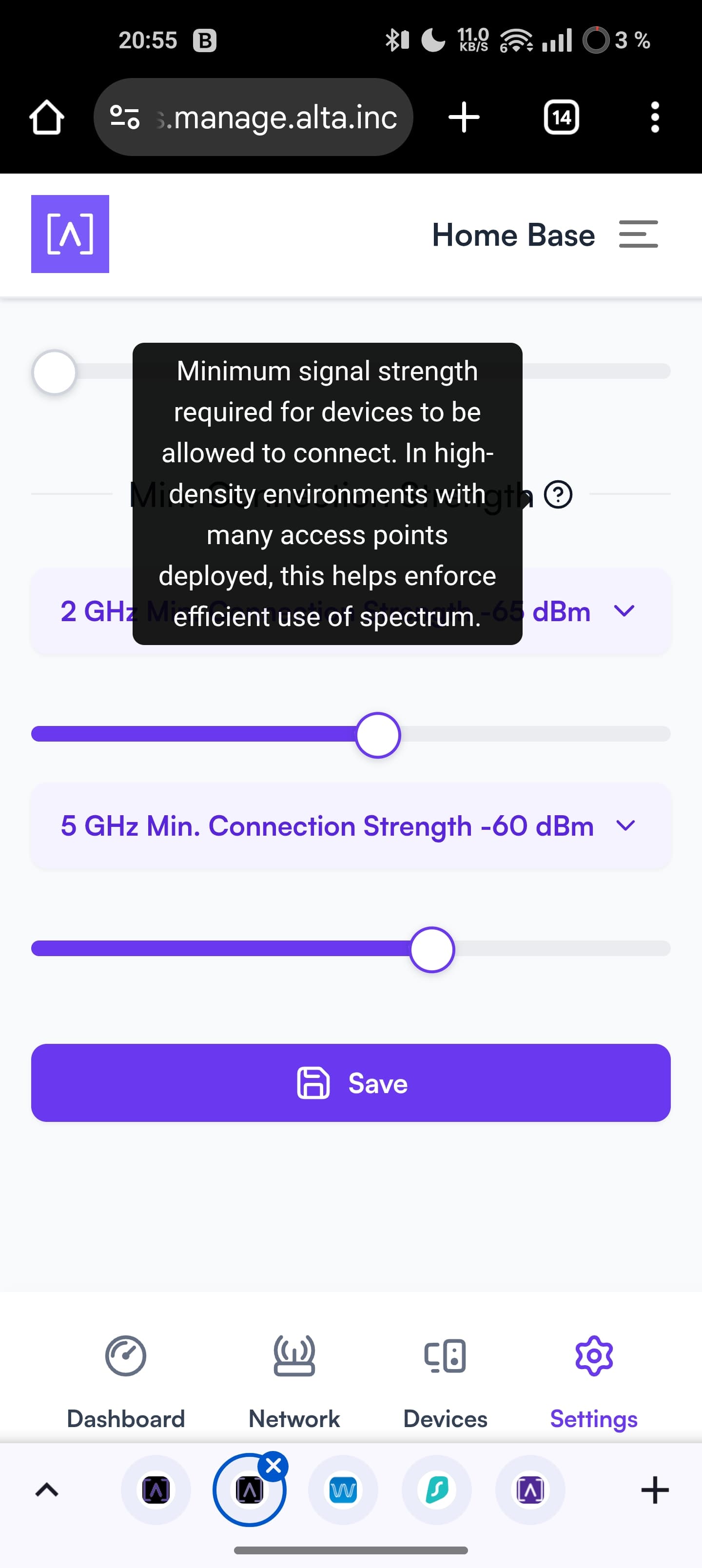

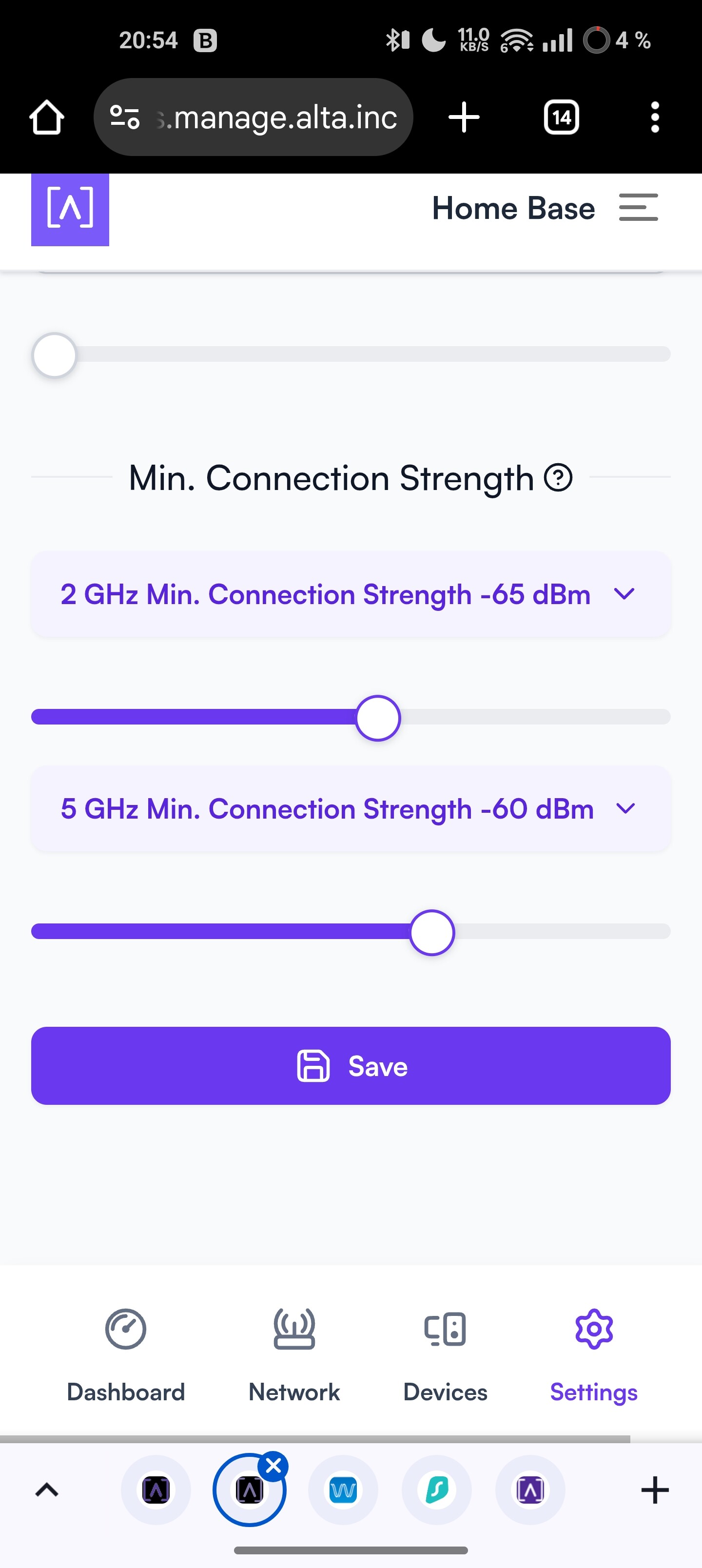

Have you experimented with the Min. Connection Strength?
I haven’t mastered and fully understood it myself…Maybe someone can contribute with more info on of this a viable way to provide steering in this case, or not.

If you want to encourage a device to roam sooner, minimum RSSI settings can help, but they require careful tuning. These settings work based on how well the AP can hear the client (STA), not the other way around. But remember: it’s the client’s perception of the AP signal that drives roaming decisions. Adjusting AP TX power is probably a better place to start, since lowering the transmit power can reduce how loud an AP appears to the client, prompting it to roam more predictably when signal levels drop.
