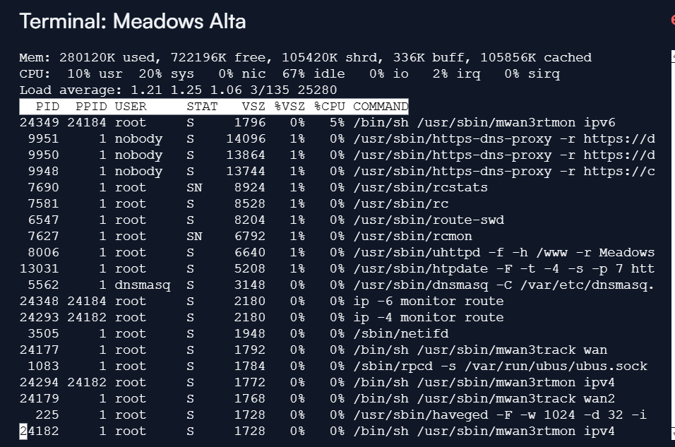

Yes. The top two or three lines of top would likely tell us what might be happening.
Acceleration is on,
What about settings for upload/download limit (CAKE)?
Also, have you tried unplugging wired devices, one by one, to see if something changes?
The output from top sums to 30% but only 5% is accounted for by the shown entries…so it would be interesting to see where the remaining 25% comes from. Some hidden process or processes running berserk?!

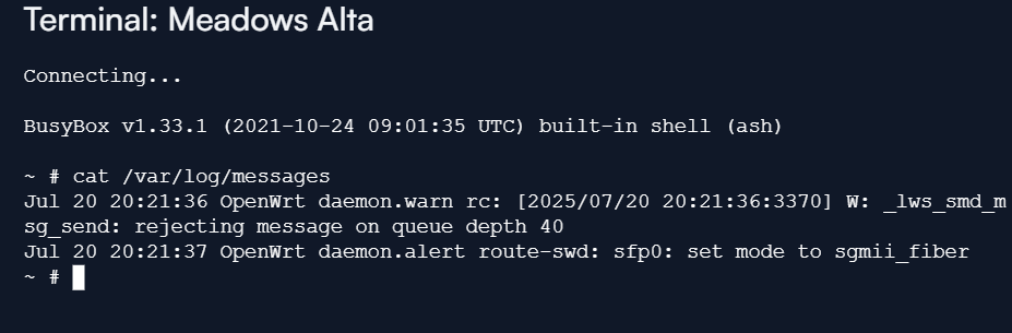

  • Check the system log in the router and see if it’s reporting any strange activity. Easiest way remotely would probably be to go to the terminal again and run cat /var/log/messages.

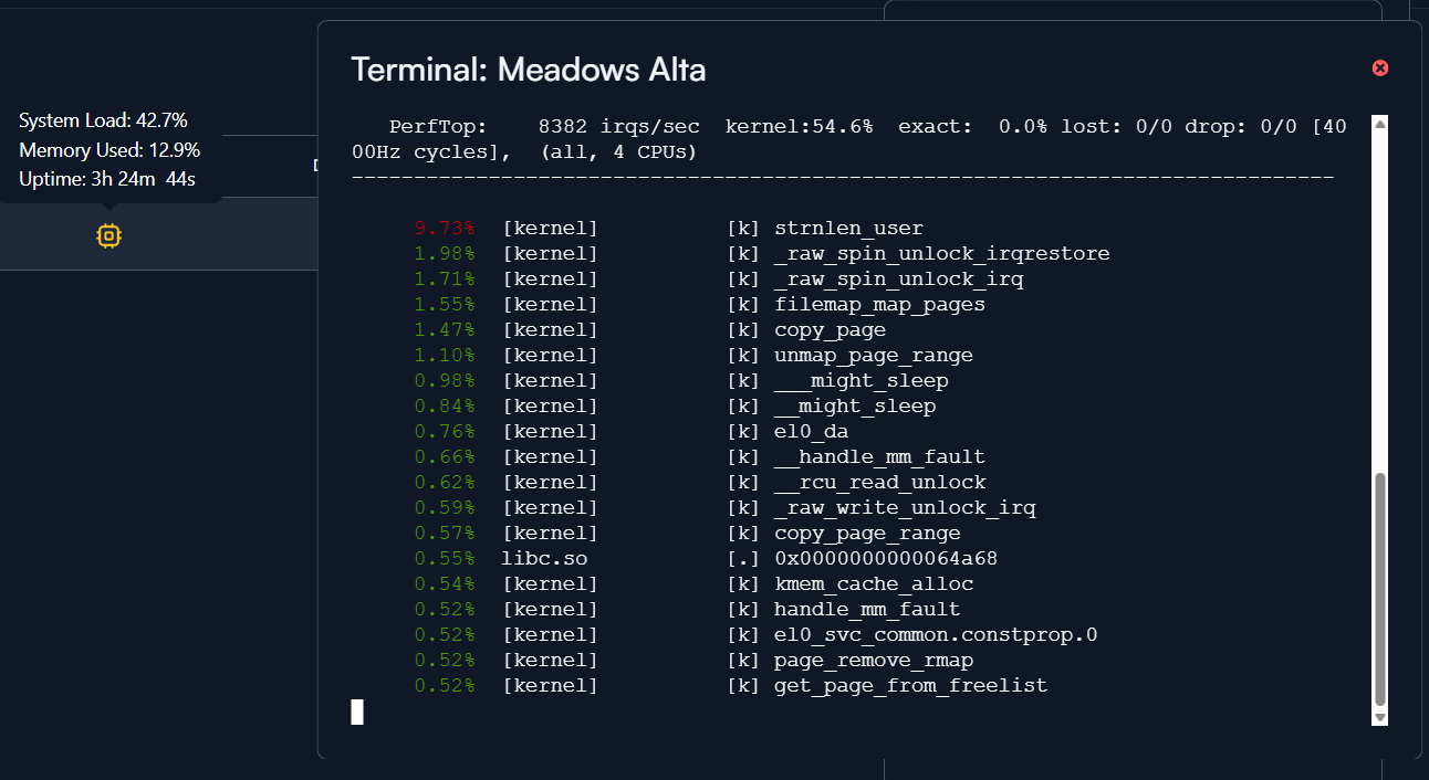

  • Since top reported 20% system CPU usage, we might have more luck with the command perf top. I just found out it’s in the router and might shed some more light on that system CPU usage
here are the things you requested, i must be honest i do not have much experience in these types of situations. but i can follow directions well enough
Thanks for your help and input
Hey, here’s hoping we find something that might explain what you’re seeing. I’m not exactly a master of working from the terminal myself, but I have a little prior experience at pulling information for troubleshooting out of Linux devices like the Route10.
That screenshot of the messages seems pretty short. I usually see a lot more messages in the log if the router has been up for any length of time. Think you could run the command dmesg next? That should spit out something kinda long but you should be able to select the text then copy and paste it. Using the Preformatted Text button (</>) should help keep the text looking neat and readable.

Jul 20 21:10:16 OpenWrt daemon.warn rc: [2025/07/20 21:10:16:7017] W: _lws_smd_msg_send: rejecting message on queue depth 40
Jul 20 21:10:16 OpenWrt daemon.warn rc: [2025/07/20 21:10:16:7018] W: _lws_smd_msg_send: rejecting message on queue depth 40
Jul 20 21:10:16 OpenWrt daemon.warn rc: [2025/07/20 21:10:16:7021] W: _lws_smd_msg_send: rejecting message on queue depth 40
Jul 20 21:10:16 OpenWrt daemon.warn rc: [2025/07/20 21:10:16:7023] W: _lws_smd_msg_send: rejecting message on queue depth 40
Jul 20 21:10:16 OpenWrt daemon.warn rc: [2025/07/20 21:10:16:7026] W: _lws_smd_msg_send: rejecting message on queue depth 40
Jul 20 21:10:16 OpenWrt daemon.warn rc: [2025/07/20 21:10:16:7028] W: _lws_smd_msg_send: rejecting message on queue depth 40
Jul 20 21:10:16 OpenWrt daemon.warn rc: [2025/07/20 21:10:16:7031] W: _lws_smd_msg_send: rejecting message on queue depth 40
Jul 20 21:10:16 OpenWrt daemon.warn rc: [2025/07/20 21:10:16:7092] W: _lws_smd_msg_send: rejecting message on queue depth 40
Jul 20 21:10:16 OpenWrt daemon.warn rc: [2025/07/20 21:10:16:7093] W: _lws_smd_msg_send: rejecting message on queue depth 40
Jul 20 21:10:16 OpenWrt daemon.warn rc: [2025/07/20 21:10:16:7096] W: _lws_smd_msg_send: rejecting message on queue depth 40
Jul 20 21:10:16 OpenWrt daemon.warn rc: [2025/07/20 21:10:16:7097] W: _lws_smd_msg_send: rejecting message on queue depth 40
Jul 20 21:10:17 OpenWrt daemon.warn rc: [2025/07/20 21:10:17:8502] W: _lws_smd_msg_send: rejecting message on queue depth 40
Jul 20 21:10:17 OpenWrt daemon.warn rc: [2025/07/20 21:10:17:8503] W: _lws_smd_msg_send: rejecting message on queue depth 40
Jul 20 21:10:17 OpenWrt daemon.warn rc: [2025/07/20 21:10:17:8506] W: _lws_smd_msg_send: rejecting message on queue depth 40
Jul 20 21:10:17 OpenWrt daemon.warn rc: [2025/07/20 21:10:17:8508] W: _lws_smd_msg_send: rejecting message on queue depth 40
Jul 20 21:10:17 OpenWrt daemon.warn rc: [2025/07/20 21:10:17:8511] W: _lws_smd_msg_send: rejecting message on queue depth 40
Jul 20 21:10:17 OpenWrt daemon.warn rc: [2025/07/20 21:10:17:8513] W: _lws_smd_msg_send: rejecting message on queue depth 40
Jul 20 21:10:17 OpenWrt daemon.warn rc: [2025/07/20 21:10:17:8520] W: _lws_smd_msg_send: rejecting message on queue depth 40
Jul 20 21:10:17 OpenWrt daemon.warn rc: [2025/07/20 21:10:17:8521] W: _lws_smd_msg_send: rejecting message on queue depth 40
Jul 20 21:10:19 OpenWrt daemon.warn rc: [2025/07/20 21:10:19:7037] W: _lws_smd_msg_send: rejecting message on queue depth 40
Jul 20 21:10:19 OpenWrt daemon.warn rc: [2025/07/20 21:10:19:7038] W: _lws_smd_msg_send: rejecting message on queue depth 40
Jul 20 21:10:19 OpenWrt daemon.warn rc: [2025/07/20 21:10:19:7077] W: _lws_smd_msg_send: rejecting message on queue depth 40
Jul 20 21:10:19 OpenWrt daemon.warn rc: [2025/07/20 21:10:19:7078] W: _lws_smd_msg_send: rejecting message on queue depth 40
Jul 20 21:10:19 OpenWrt daemon.warn rc: [2025/07/20 21:10:19:7080] W: _lws_smd_msg_send: rejecting message on queue depth 40
Jul 20 21:10:19 OpenWrt daemon.warn rc: [2025/07/20 21:10:19:7081] W: _lws_smd_msg_send: rejecting message on queue depth 40
Jul 20 21:10:19 OpenWrt daemon.warn rc: [2025/07/20 21:10:19:7082] W: _lws_smd_msg_send: rejecting message on queue depth 40
Jul 20 21:10:19 OpenWrt daemon.warn rc: [2025/07/20 21:10:19:7083] W: _lws_smd_msg_send: rejecting message on queue depth 40
Jul 20 21:10:24 OpenWrt daemon.warn rc: [2025/07/20 21:10:24:5525] W: _lws_smd_msg_send: rejecting message on queue depth 40
Jul 20 21:10:27 OpenWrt daemon.alert route-swd: sfp0: set mode to 10gbase_r
Jul 20 21:10:30 OpenWrt daemon.warn rc: [2025/07/20 21:10:30:4056] W: _lws_smd_msg_send: rejecting message on queue depth 40
Jul 20 21:10:30 OpenWrt daemon.warn rc: [2025/07/20 21:10:30:4057] W: _lws_smd_msg_send: rejecting message on queue depth 40
Jul 20 21:10:33 OpenWrt daemon.warn rc: [2025/07/20 21:10:33:5600] W: _lws_smd_msg_send: rejecting message on queue depth 40
Jul 20 21:10:33 OpenWrt daemon.warn rc: [2025/07/20 21:10:33:5602] W: _lws_smd_msg_send: rejecting message on queue depth 40
Jul 20 21:10:36 OpenWrt daemon.warn rc: [2025/07/20 21:10:36:7055] W: _lws_smd_msg_send: rejecting message on queue depth 40
Jul 20 21:10:36 OpenWrt daemon.warn rc: [2025/07/20 21:10:36:7057] W: _lws_smd_msg_send: rejecting message on queue depth 40
Jul 20 21:10:42 OpenWrt daemon.warn rc: [2025/07/20 21:10:42:0024] W: _lws_smd_msg_send: rejecting message on queue depth 40
Jul 20 21:10:42 OpenWrt daemon.warn rc: [2025/07/20 21:10:42:0025] W: _lws_smd_msg_send: rejecting message on queue depth 40
Jul 20 21:10:42 OpenWrt daemon.alert route-swd: sfp0: set mode to sgmii_fiber
Jul 20 21:10:44 OpenWrt daemon.warn rc: [2025/07/20 21:10:44:1316] W: _lws_smd_msg_send: rejecting message on queue depth 40
Jul 20 21:10:44 OpenWrt daemon.warn rc: [2025/07/20 21:10:44:1317] W: _lws_smd_msg_send: rejecting message on queue depth 40
Jul 20 21:10:44 OpenWrt daemon.warn rc: [2025/07/20 21:10:44:1357] W: _lws_smd_msg_send: rejecting message on queue depth 40
Jul 20 21:10:44 OpenWrt daemon.warn rc: [2025/07/20 21:10:44:1359] W: _lws_smd_msg_send: rejecting message on queue depth 40
Jul 20 21:10:44 OpenWrt daemon.warn rc: [2025/07/20 21:10:44:1361] W: _lws_smd_msg_send: rejecting message on queue depth 40
Jul 20 21:10:44 OpenWrt daemon.warn rc: [2025/07/20 21:10:44:1364] W: _lws_smd_msg_send: rejecting message on queue depth 40
Jul 20 21:10:44 OpenWrt daemon.warn rc: [2025/07/20 21:10:44:1365] W: _lws_smd_msg_send: rejecting message on queue depth 40
Jul 20 21:10:46 OpenWrt daemon.warn rc: [2025/07/20 21:10:46:0400] W: _lws_smd_msg_send: rejecting message on queue depth 40
Jul 20 21:10:46 OpenWrt daemon.warn rc: [2025/07/20 21:10:46:0402] W: _lws_smd_msg_send: rejecting message on queue depth 40
Jul 20 21:10:46 OpenWrt daemon.warn rc: [2025/07/20 21:10:46:0405] W: _lws_smd_msg_send: rejecting message on queue depth 40
Jul 20 21:10:46 OpenWrt daemon.warn rc: [2025/07/20 21:10:46:0407] W: _lws_smd_msg_send: rejecting message on queue depth 40
Jul 20 21:10:46 OpenWrt daemon.warn rc: [2025/07/20 21:10:46:0410] W: _lws_smd_msg_send: rejecting message on queue depth 40
Jul 20 21:10:46 OpenWrt daemon.warn rc: [2025/07/20 21:10:46:0412] W: _lws_smd_msg_send: rejecting message on queue depth 40
Jul 20 21:10:54 OpenWrt daemon.warn rc: [2025/07/20 21:10:54:4669] W: _lws_smd_msg_send: rejecting message on queue depth 40
Jul 20 21:10:54 OpenWrt daemon.warn rc: [2025/07/20 21:10:54:4670] W: _lws_smd_msg_send: rejecting message on queue depth 40
Jul 20 21:10:54 OpenWrt daemon.warn rc: [2025/07/20 21:10:54:4672] W: _lws_smd_msg_send: rejecting message on queue depth 40
Jul 20 21:10:54 OpenWrt daemon.warn rc: [2025/07/20 21:10:54:4675] W: _lws_smd_msg_send: rejecting message on queue depth 40
Jul 20 21:10:54 OpenWrt daemon.warn rc: [2025/07/20 21:10:54:4677] W: _lws_smd_msg_send: rejecting message on queue depth 40
Jul 20 21:10:55 OpenWrt daemon.alert route-swd: sfp0: set mode to sgmii_fiber
Jul 20 21:10:57 OpenWrt daemon.warn rc: [2025/07/20 21:10:57:2581] W: _lws_smd_msg_send: rejecting message on queue depth 40
Jul 20 21:10:57 OpenWrt daemon.warn rc: [2025/07/20 21:10:57:2585] W: _lws_smd_msg_send: rejecting message on queue depth 40
Jul 20 21:11:11 OpenWrt daemon.alert route-swd: sfp0: set mode to sgmii_fiber
Jul 20 21:11:31 OpenWrt daemon.alert route-swd: sfp0: set mode to 10gbase_r
Jul 20 21:11:44 OpenWrt daemon.notice netifd: wan26 (20166): cat: write error: Broken pipe
Jul 20 21:11:49 OpenWrt daemon.alert route-swd: sfp0: set mode to sgmii_fiber
Jul 20 21:11:56 OpenWrt daemon.notice rc: [2025/07/20 21:11:56:8612] N: JSON: {"reqStats":{"start":1753063855,"stop":1753063916,"period":"seconds","clientId":"lvLNz2SBQwEtPvQIGT0X"}}
Jul 20 21:12:00 OpenWrt daemon.notice rc: [2025/07/20 21:12:00:8479] N: JSON: {"reqStats":{"start":1753063859,"stop":1753063920,"period":"seconds","clientId":"lvLNz2SBQwEtPvQIGT0X"}}
Jul 20 21:12:02 OpenWrt daemon.warn rc: [2025/07/20 21:12:02:1677] W: _lws_smd_msg_send: rejecting message on queue depth 40
Jul 20 21:12:02 OpenWrt daemon.warn rc: [2025/07/20 21:12:02:1678] W: _lws_smd_msg_send: rejecting message on queue depth 40
Jul 20 21:12:02 OpenWrt daemon.warn rc: [2025/07/20 21:12:02:1680] W: _lws_smd_msg_send: rejecting message on queue depth 40
Jul 20 21:12:02 OpenWrt daemon.warn rc: [2025/07/20 21:12:02:1681] W: _lws_smd_msg_send: rejecting message on queue depth 40
Jul 20 21:12:04 OpenWrt daemon.alert route-swd: sfp0: set mode to sgmii_fiber
Jul 20 21:12:12 OpenWrt daemon.notice rc: [2025/07/20 21:12:12:9273] N: JSON: {"reqStats":{"start":1753063868,"stop":1753063929,"period":"seconds","clientId":"BcbfLgaMiqyRccha9DVA"}}
Jul 20 21:12:13 OpenWrt daemon.warn rc: [2025/07/20 21:12:13:2448] W: _lws_smd_msg_send: rejecting message on queue depth 40
Jul 20 21:12:13 OpenWrt daemon.warn rc: [2025/07/20 21:12:13:2449] W: _lws_smd_msg_send: rejecting message on queue depth 40
Jul 20 21:12:13 OpenWrt daemon.warn rc: [2025/07/20 21:12:13:2451] W: _lws_smd_msg_send: rejecting message on queue depth 40
Jul 20 21:12:17 OpenWrt daemon.alert route-swd: sfp0: set mode to sgmii_fiber
Jul 20 21:12:20 OpenWrt daemon.notice rc: [2025/07/20 21:12:20:9309] N: JSON: {"reqStats":{"start":1753063876,"stop":1753063937,"period":"seconds","clientId":"BcbfLgaMiqyRccha9DVA"}}
Jul 20 21:12:32 OpenWrt daemon.alert route-swd: sfp0: set mode to 10gbase_r
Jul 20 21:12:48 OpenWrt daemon.notice rc: [2025/07/20 21:12:48:3084] N: JSON: {"stats":120}
Jul 20 21:12:48 OpenWrt daemon.notice rc: [2025/07/20 21:12:48:3390] N: JSON: {"stats":120}
Jul 20 21:12:48 OpenWrt daemon.notice rc: [2025/07/20 21:12:48:3689] N: JSON: {"reqStats":{"start":1753063904,"stop":1753063965,"period":"seconds","clientId":"BcbfLgaMiqyRccha9DVA"}}
Jul 20 21:12:50 OpenWrt daemon.alert route-swd: sfp0: set mode to sgmii_fiber
Jul 20 21:12:54 OpenWrt daemon.notice rc: [2025/07/20 21:12:54:9668] N: JSON: {"reqStats":{"start":1753063910,"stop":1753063971,"period":"seconds","clientId":"BcbfLgaMiqyRccha9DVA"}}
Jul 20 21:12:57 OpenWrt daemon.warn rc: [2025/07/20 21:12:57:9346] W: _lws_smd_msg_send: rejecting message on queue depth 40
Jul 20 21:12:57 OpenWrt daemon.warn rc: [2025/07/20 21:12:57:9348] W: _lws_smd_msg_send: rejecting message on queue depth 40
Jul 20 21:12:57 OpenWrt daemon.warn rc: [2025/07/20 21:12:57:9350] W: _lws_smd_msg_send: rejecting message on queue depth 40
Jul 20 21:12:57 OpenWrt daemon.warn rc: [2025/07/20 21:12:57:9353] W: _lws_smd_msg_send: rejecting message on queue depth 40
Jul 20 21:12:57 OpenWrt daemon.warn rc: [2025/07/20 21:12:57:9354] W: _lws_smd_msg_send: rejecting message on queue depth 40
Jul 20 21:12:57 OpenWrt daemon.warn rc: [2025/07/20 21:12:57:9356] W: _lws_smd_msg_send: rejecting message on queue depth 40
Jul 20 21:12:57 OpenWrt daemon.warn rc: [2025/07/20 21:12:57:9359] W: _lws_smd_msg_send: rejecting message on queue depth 40
Jul 20 21:12:57 OpenWrt daemon.warn rc: [2025/07/20 21:12:57:9360] W: _lws_smd_msg_send: rejecting message on queue depth 40
Jul 20 21:12:57 OpenWrt daemon.warn rc: [2025/07/20 21:12:57:9362] W: _lws_smd_msg_send: rejecting message on queue depth 40
Jul 20 21:12:57 OpenWrt daemon.warn rc: [2025/07/20 21:12:57:9365] W: _lws_smd_msg_send: rejecting message on queue depth 40
Jul 20 21:13:00 OpenWrt daemon.notice rc: [2025/07/20 21:13:00:2624] N: JSON: {"stats":120}
Jul 20 21:13:00 OpenWrt daemon.notice rc: [2025/07/20 21:13:00:6458] N: JSON: {"reqStats":{"start":1753063916,"stop":1753063977,"period":"seconds","clientId":"cpDRu7GBVA2GpYvnH2tV"}}
Jul 20 21:13:05 OpenWrt daemon.alert route-swd: sfp0: set mode to sgmii_fiber
Jul 20 21:13:22 OpenWrt daemon.alert route-swd: sfp0: set mode to sgmii_fiber
Jul 20 21:13:33 OpenWrt daemon.alert route-swd: sfp0: set mode to 10gbase_r
Jul 20 21:13:34 OpenWrt daemon.notice netifd: wan26 (20166): cat: write error: Broken pipe
Jul 20 21:13:42 OpenWrt daemon.notice netifd: wan26 (20166): cat: write error: Broken pipe
Jul 20 21:13:49 OpenWrt daemon.alert route-swd: sfp0: set mode to sgmii_fiber
Jul 20 21:13:55 OpenWrt daemon.warn rc: [2025/07/20 21:13:55:8813] W: _lws_smd_msg_send: rejecting message on queue depth 40
Jul 20 21:13:55 OpenWrt daemon.warn rc: [2025/07/20 21:13:55:8815] W: _lws_smd_msg_send: rejecting message on queue depth 40
Jul 20 21:14:06 OpenWrt daemon.alert route-swd: sfp0: set mode to sgmii_fiber
Jul 20 21:14:14 OpenWrt daemon.warn rc: [2025/07/20 21:14:14:0687] W: _lws_smd_msg_send: rejecting message on queue depth 40
Jul 20 21:14:14 OpenWrt daemon.warn rc: [2025/07/20 21:14:14:0689] W: _lws_smd_msg_send: rejecting message on queue depth 40
Jul 20 21:14:15 OpenWrt daemon.warn rc: [2025/07/20 21:14:15:9636] W: _lws_smd_msg_send: rejecting message on queue depth 40
Jul 20 21:14:15 OpenWrt daemon.warn rc: [2025/07/20 21:14:15:9637] W: _lws_smd_msg_send: rejecting message on queue depth 40
Jul 20 21:14:21 OpenWrt daemon.alert route-swd: sfp0: set mode to sgmii_fiber
Jul 20 21:14:37 OpenWrt daemon.alert route-swd: sfp0: set mode to 10gbase_r
Jul 20 21:14:37 OpenWrt daemon.warn rc: [2025/07/20 21:14:37:8215] W: _lws_smd_msg_send: rejecting message on queue depth 40
Jul 20 21:14:37 OpenWrt daemon.warn rc: [2025/07/20 21:14:37:8218] W: _lws_smd_msg_send: rejecting message on queue depth 40
Jul 20 21:14:56 OpenWrt daemon.alert route-swd: sfp0: set mode to sgmii_fiber
Jul 20 21:14:58 OpenWrt daemon.notice rc: [2025/07/20 21:14:58:9410] N: JSON: {"stats":120}
Jul 20 21:14:59 OpenWrt daemon.notice rc: [2025/07/20 21:14:59:0048] N: JSON: {"reqStats":{"start":1753064034,"stop":1753064095,"period":"seconds","clientId":"BcbfLgaMiqyRccha9DVA"}}
Jul 20 21:15:01 OpenWrt daemon.notice rc: [2025/07/20 21:15:01:8747] N: JSON: {"reqStats":{"start":1753064040,"stop":1753064101,"period":"seconds","clientId":"lvLNz2SBQwEtPvQIGT0X"}}
Jul 20 21:15:09 OpenWrt daemon.alert route-swd: sfp0: set mode to sgmii_fiber
Jul 20 21:15:22 OpenWrt daemon.alert route-swd: sfp0: set mode to sgmii_fiber
Jul 20 21:15:36 OpenWrt daemon.alert route-swd: sfp0: set mode to 10gbase_r
Jul 20 21:15:40 OpenWrt daemon.warn rc: [2025/07/20 21:15:40:8209] W: _lws_smd_msg_send: rejecting message on queue depth 40
Jul 20 21:15:49 OpenWrt daemon.notice rc: [2025/07/20 21:15:49:6742] N: JSON: {"stats":120}
Jul 20 21:15:49 OpenWrt daemon.alert route-swd: sfp0: set mode to sgmii_fiber
Jul 20 21:15:51 OpenWrt daemon.warn rc: [2025/07/20 21:15:51:7847] W: Open session Bcb
Jul 20 21:15:51 OpenWrt daemon.alert rc: login by root!
Jul 20 21:15:52 OpenWrt daemon.warn rc: [2025/07/20 21:15:52:8274] W: _lws_smd_msg_send: rejecting message on queue depth 40
Jul 20 21:15:52 OpenWrt daemon.warn rc: [2025/07/20 21:15:52:8275] W: _lws_smd_msg_send: rejecting message on queue depth 40

Seems like there is some excess logging going on (in /var/log/messages/) and possibly going wrong…that might also be the reason for those additional 20-25 % CPU usage!? I don’t see any of those on my Route10. The reason for the message flooding, I don’t know, however.
My gut reaction to these is the router is getting upset over whatever might be connected to WAN2 (the SFP+ port) and it’s going wild logging things. But that’s just my initial reaction when looking over these logs, assuming I’m properly understanding the layout based on them.
What exactly is connected to the router at this site? You mentioned it was only a few things but a little description of the layout or diagram might be a helpful next step
