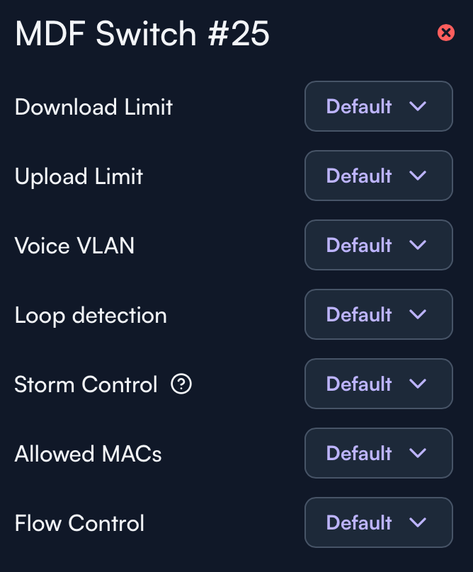

What is "Default" for flow control on switch ports?
As the title says, can you clarify what “Default” is for flow control on the S24 switch ports?

Flow control is default off/disabled on our switches. Top to bottom defaults for your screenshot:
  • No limit
  • No limit
  • None
  • On
  • No limit
  • Disabled
  • Off
