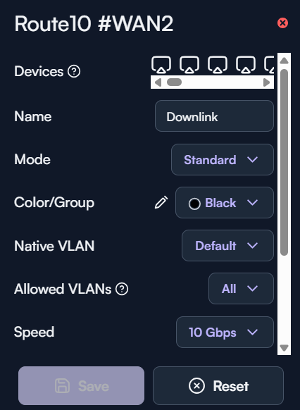

The UI is showing VLAN 2 when it should be showing VLAN 20
Would you mind sharing a screenshot for the particular switch port?
No problem, its one of the SFP+ ports that is my downlink to my core switch

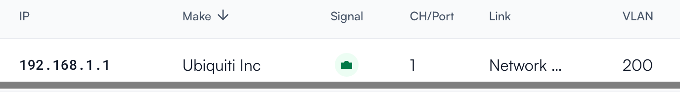

Hmm, are there multiple VLANs on that connection? I spotted this recently at a site with a Ubiquiti EdgeRouter and Alta S24-POE that reminds me of this:
Technically the native VLAN is 1 and 200 is the tagged VLAN for VoIP traffic. Just struck me as similar!
That is my only downlink I have VLAN 1 and VLAN 20 thats it, VLAN 2 doesnt even exist, the only thing I can think is how many VLAN are on that connection maybe, let me make another vlan and see if it shows.
Oh it turns out I have a third VLAN 31 for testing that is on that port as well.
This is known problem, pretty old one too. I see vlans I dont have, vlans are just wrong or no vlan at all. Bugs are plenty.
Ah a known bug ok thanks
