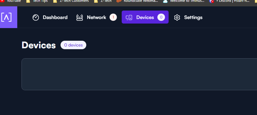

Upgraded to 1.1d from whatever came with the new device. The web console was working perfectly before. Now it shows 0 clients attached but all the clients are connected and do have WiFi access.

I think I may have figured something out. So my main SSID seems to be having the issue. If I create a new SSID and connect devices, they appear instantly. But utilizing my main SSID it doesn’t work.
Is there a way to “reset” it on the backend systems so it purges any info about the old SSID?

@Z-Tech We’ve identified the problem and will release a fix in 1.1f. Sorry for the troubles.

Can you try updating to v1.1f and see if it helps? You can click the up-arrow:
Seems to be picking up the other SSID now with the associated clients!
