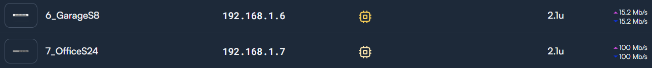

Upgrade does not show on UI
Hi,
Yesterday I upgraded my 2 switches from my Android App and everything looks like the upgrade has been completed to 2.3a
So today I was on the WEB portal and to my surprise the same 2.1u version os in the system again but with no upgrade symbol.
Is there any bug in the system that will make this to happen?
Shouldn’t upgrade on one APP also reflect on the WEB portal?
Could someone give a plausable explanation why this can happen?
Firmware was pulled that evening due to an issue reported with the S24 switches. Link to the post for reference: [PULLED] Switch Firmware 2.3a Released! - #6 by Alta-MikeD
