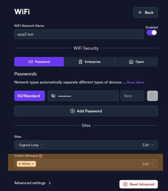

Black cannot be removed from an AP at all. This is intentional. Remove black from the SSID itself instead.
You could lift your SSIDs all off of the black color this way if you want to strictly control every broadcast.
