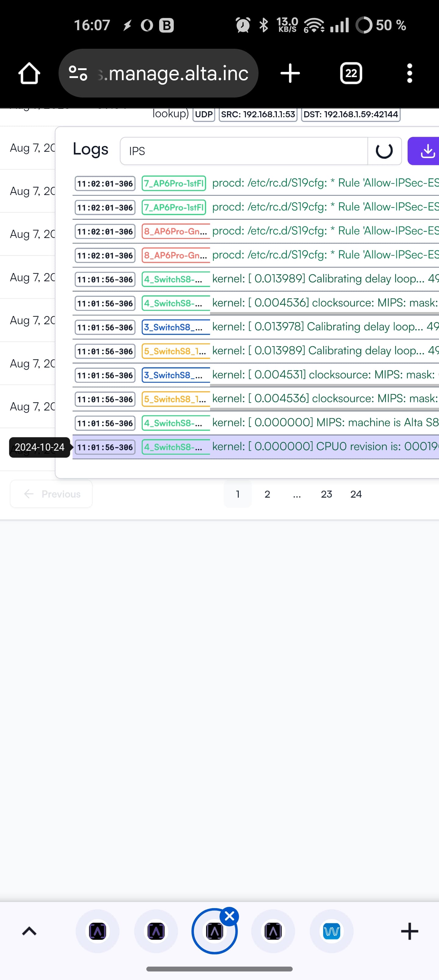

I can confirm I have seen October 24, last year, in the logs too.
Edit: For me, a portion of the log since reboot says October 24. Seems like some logs are time stamped before clock has synchronized?!

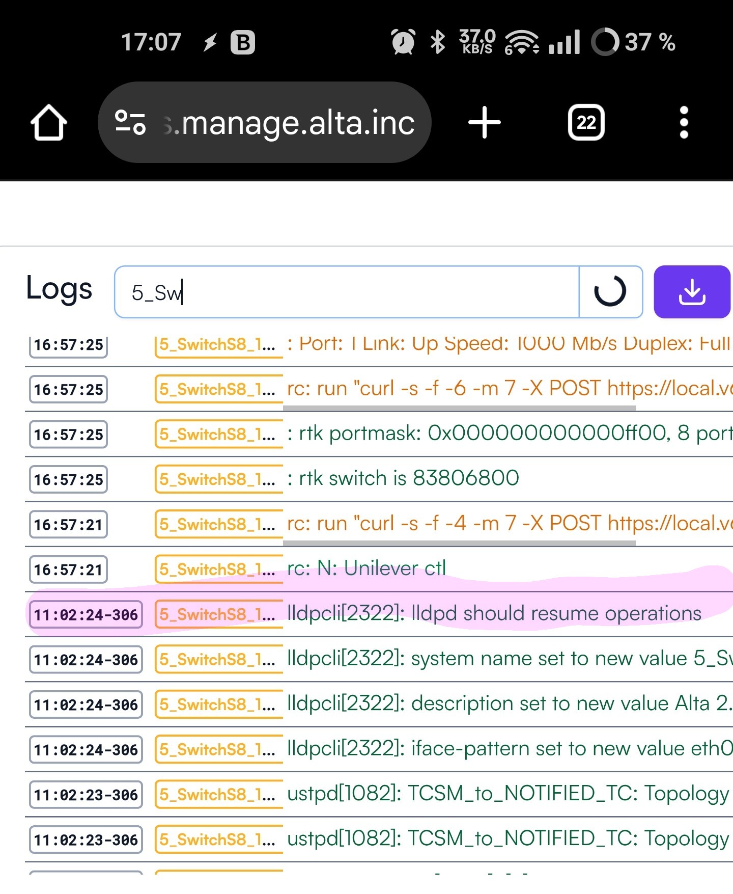

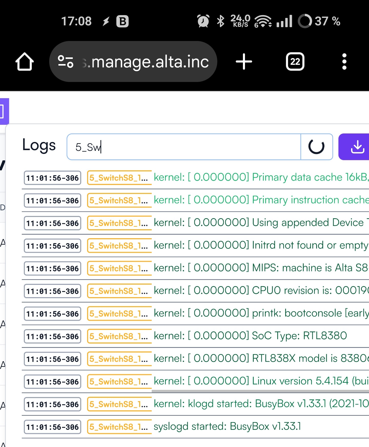

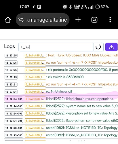

So, it seems pretty consistent. After a reboot, a portion of the logs are time stamped with the mysterious October 24, 2024. Then, after some 25-30 s (at least for the S8 switch), the time stamp turns correct. Breaking point for one startup marked in screenshot below. The specific log event does not seem to be associated to the point where time stamp turns correct. I guess this might be hard to work around altogether if there is no built in battery that help maintain time over reboots?!

The logs on October 24 are expected, and are due to the device not having a time sync when it first boots.
