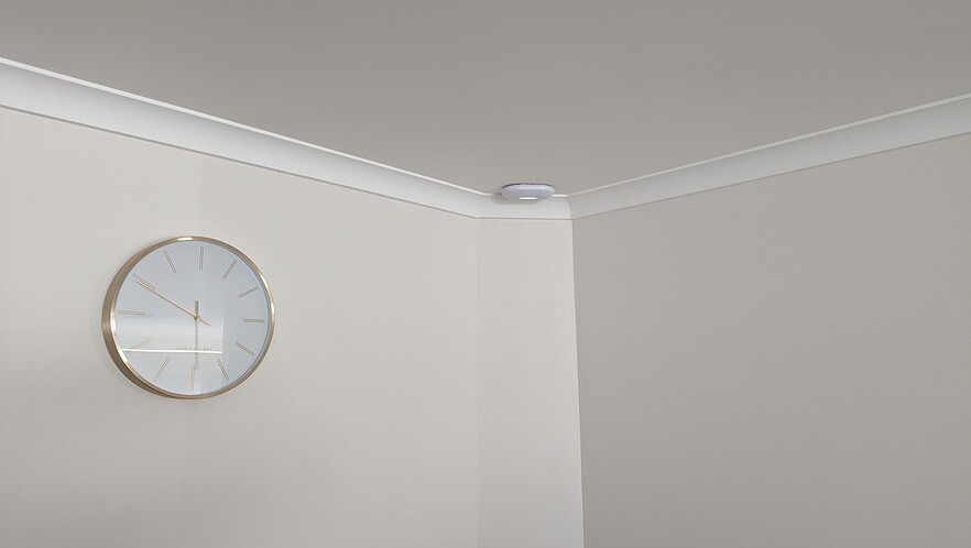

Also, our AP6 Pro is probably “less than ideally” mounted (ie. not in the direct center of the main living area), more for aesthetic reasons.
