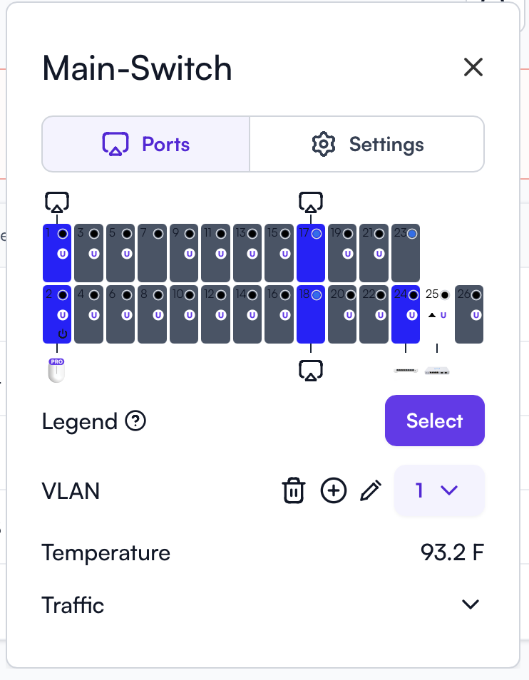

This has already been added, by the way. You can assign multiple ports to a color, and the color/group can have native VLAN and allowed VLAN settings attached to it.

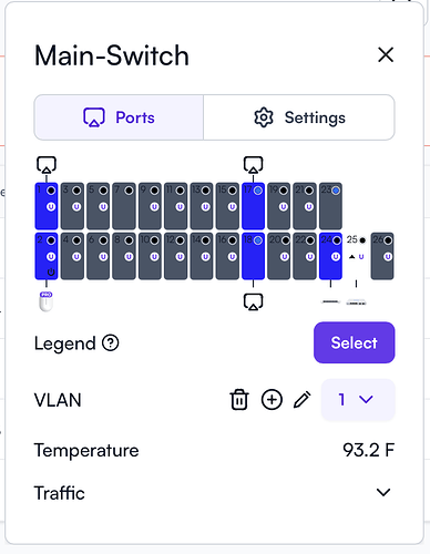

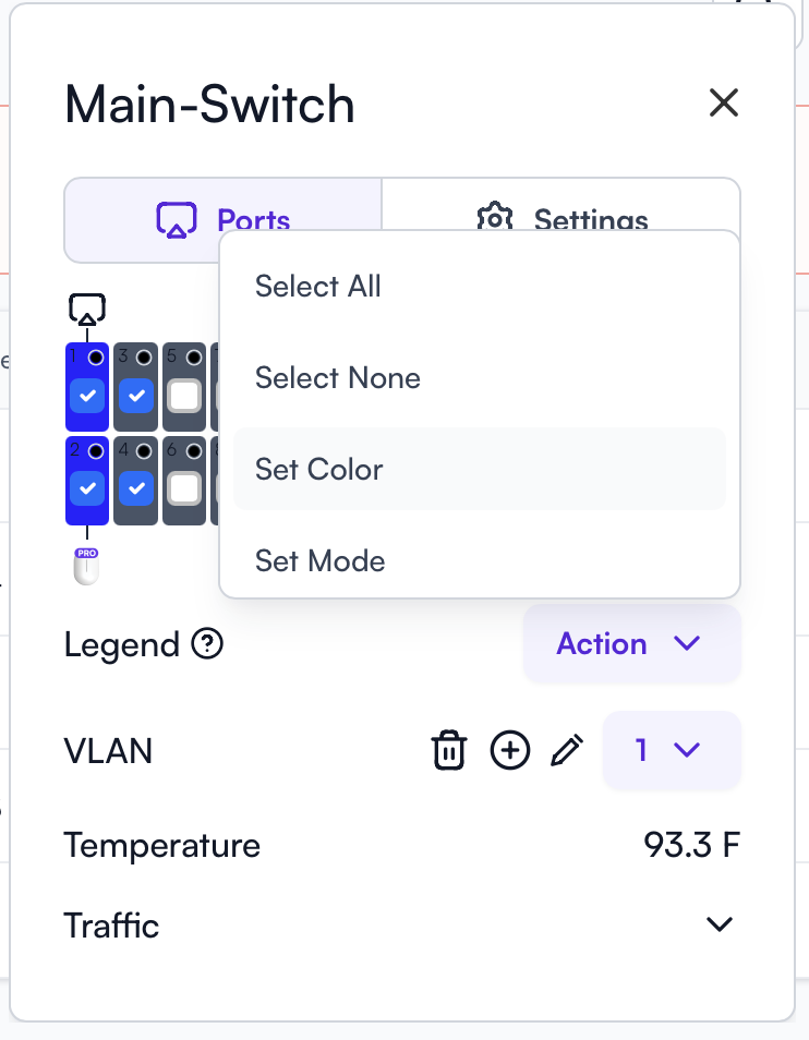

You can select multiple ports on control. Once you have selected the ports you want to change, you can then choose the color you want to assign.
Now I see.
the select button.
Hadn’t figured that out
thanks for the information.
