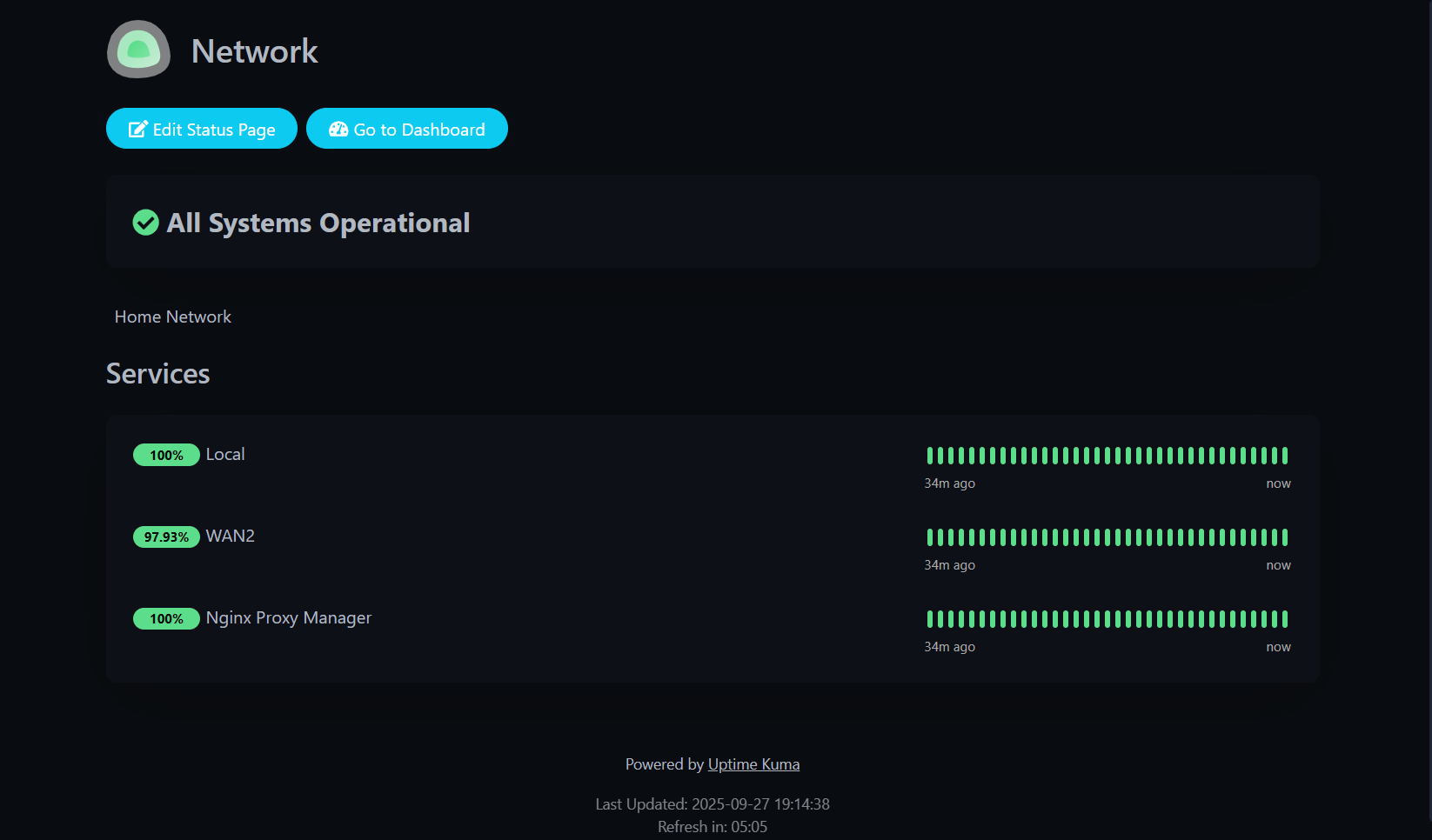

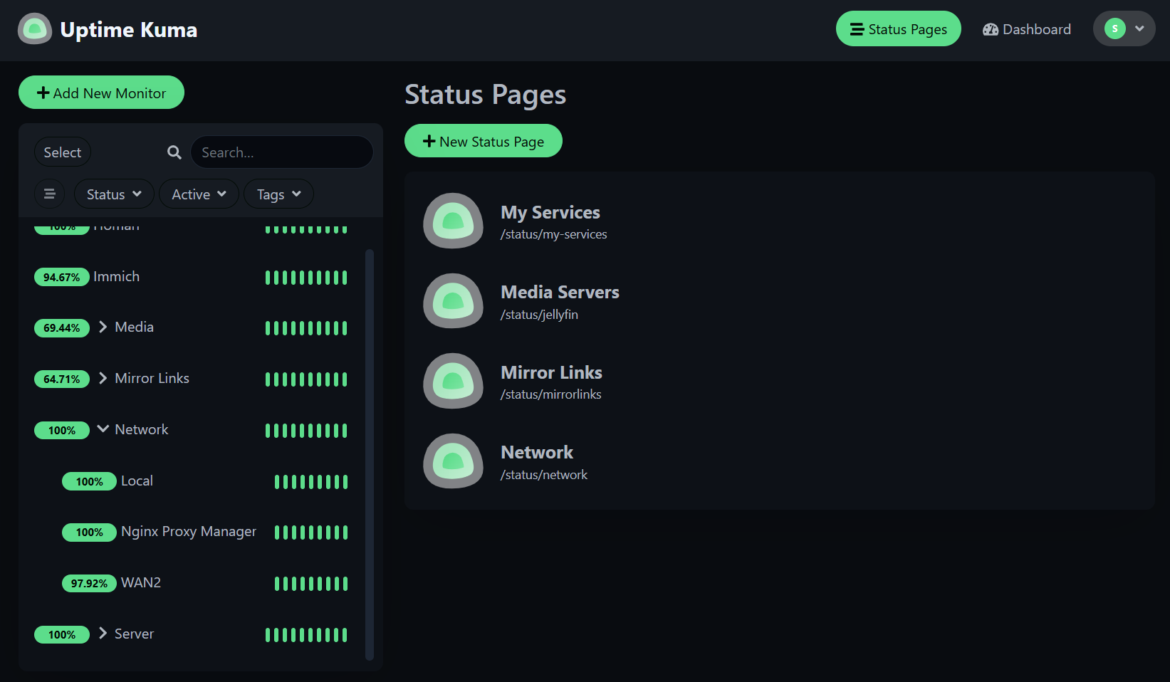

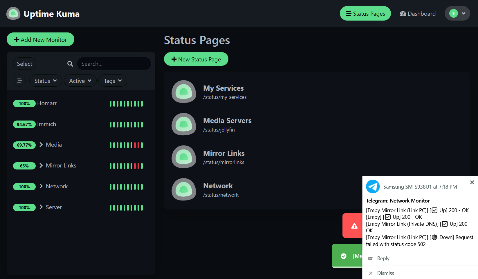

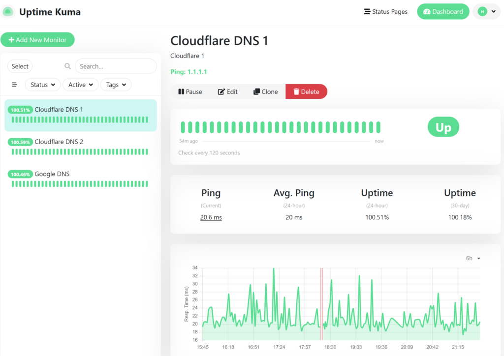

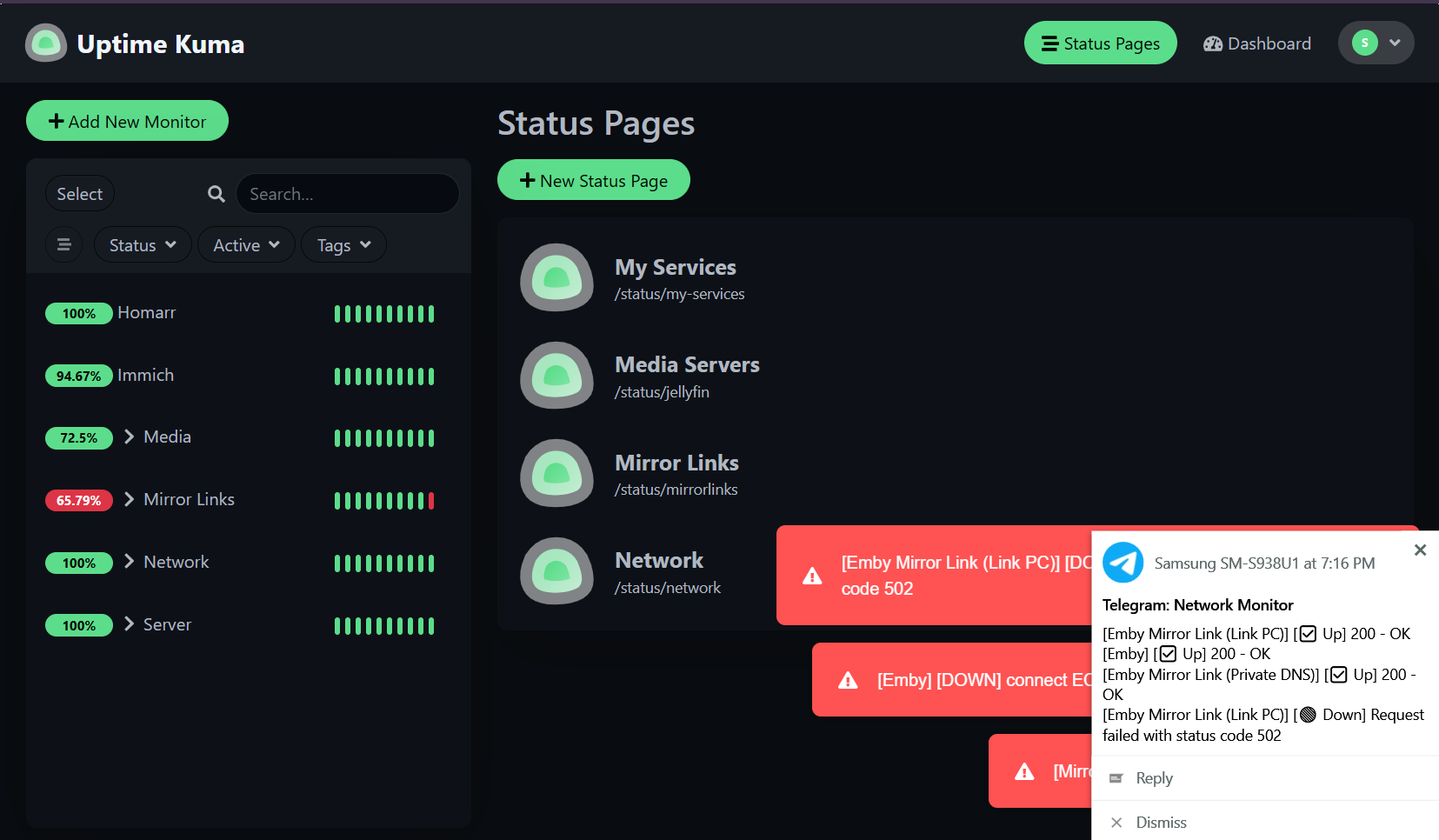

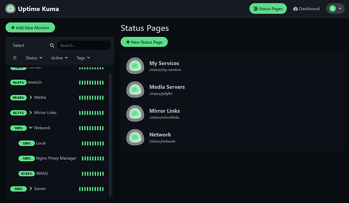

I run a program called Uptime Kuma in a docker container to monitor my various services. It dawned on me I could probably use this to monitor my connection as well. So, I set it up to ping the public ip of my main connection on 60s intervals and report the status. Uptime has several options for setting up notifications. I was using the free pushbullet option, but I reached my monthly limit so I switched the notifications to Telegram and it works perfectly.
I realize this may not be a solution for some people, but if you can implement this it will work for you as well.
Here is a link to Uptime if you’re interested. I’ve also provided some screen shots and took my media server down and brought it back up to use as an example.
