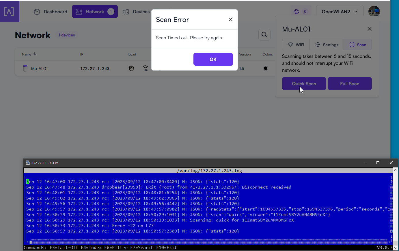

Scan Timed out message
Currently (firmware 1.1i) no WiFi scan works here. No Quick and no Full Scan. Does anyone have an idea what the problem is? The logfile in the console shows Error -22 on L77.

Could these logfile messages have something to do with it?
Blockquote
Sep 13 05:10:19 172.27.1.243 root: scanning…
Sep 13 05:10:19 172.27.1.243 root: scanning in 34 seconds (#2)…
Sep 13 05:10:53 172.27.1.243 root: scanning…
Sep 13 05:10:53 172.27.1.243 root: scanning in 10 seconds (#3)…
Sep 13 05:11:03 172.27.1.243 root: scanning…
Sep 13 05:11:03 172.27.1.243 root: scanning in 209 seconds (#4)…

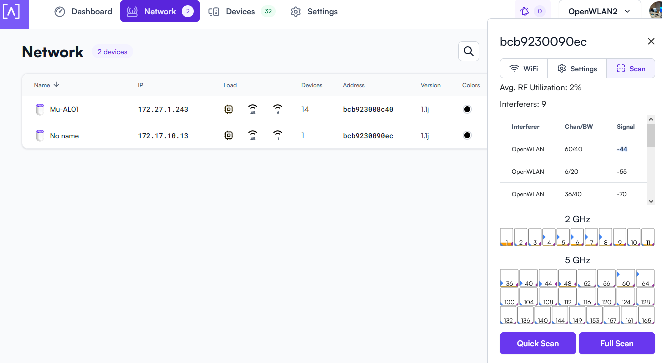

Observation:
For testing I installed two AP6-Pro in two networks.
No problems if the web browser is in the same LAN as the access point and no DFS scan is running.
If the web browser is in a different LAN there are problems.
In the screenshot my browser was in the 172.17.0.0/16 network. The problems are only when accessing (NAT) the 172.27.0.0/16 network.
Both networks are behind the same firewall.
