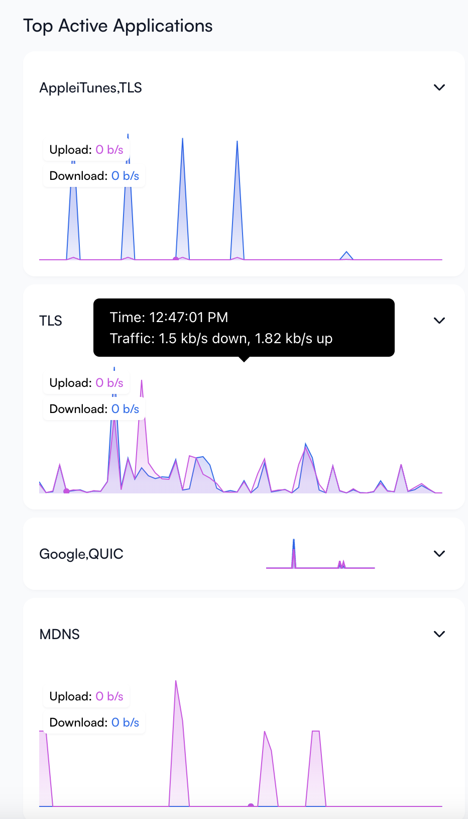

@sequoia I cannot comment on the timeframe of a router, other than it is in the pipeline. For the time being, though, in my experience, the wireless portion of any network is generally more tricky to get just right, and the real-time capabilities, DPI engine, and network type settings of the Alta interface make scalable implementation and monitoring straightforward for the wireless portion.
I’ll also add that the DPI functionality is pretty amazing (without requiring a gateway, all done from the L2 AP) … here’s mine right now :slight_smile:
