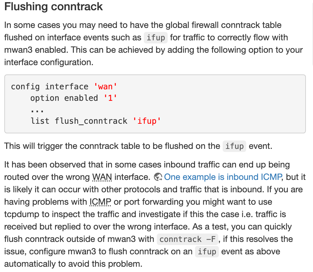

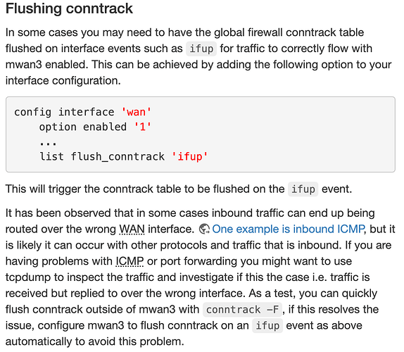

Dang, I had hoped that would do something. Otherwise as far I as I can tell there’s an option to add to the configuration file that will automatically do that as well, but it might not be worth doing if the connection tracking flush didn’t seem to do anything.
That all being said, if you’re curious here’s the bit I pulled from the OpenWRT mwan3 documentation:
I think the configuration file can be modified by going back to the terminal and typing nano /etc/config/mwan3 then that option could be added under the wan interface. Although I haven’t had a chance to test it out myself!

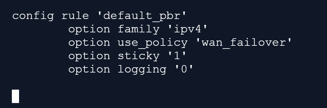

I have found a fix!
/etc/config/mwan3 - change sticky to 0, then restart mwan3 interface
Looking in to a way to stop it from reverting at reboot though
CLI command:
uci set mwan3.default_pbr.sticky=0
/etc/init.d/mwan3 restart
Might be able to add it to post-cfg.sh script so it’s loaded on startup, although I haven’t done that myself. Some examples of what others have used it for are listed here: Post your sanitized post-cfg.sh
Preferably there would be an option in the UI at some point, but it’s cool you found a fix!
