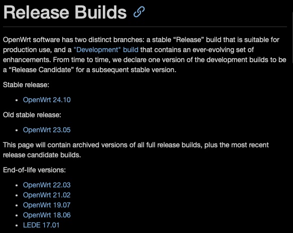

For a product we’d expect to supply to customers for several years we’d not expect it to be running an end of life release already, particularly for a security appliance.

Experience of other platforms has shown that a lagging platform OS, with all the best will in the world incorporating bug fixes/features from later releases, ultimately ends up in an unmaintainable mess that gets abandoned once a major flaw is discovered that is too hard to back port.
Chip vendor binary blobs are usually a major factor in this.

Regarding the regulation I mentioned, if we deploy 100s of these in our FTTH we do not want to have to replace them all in a few years once official vendor support ends, just to stay compliant.
